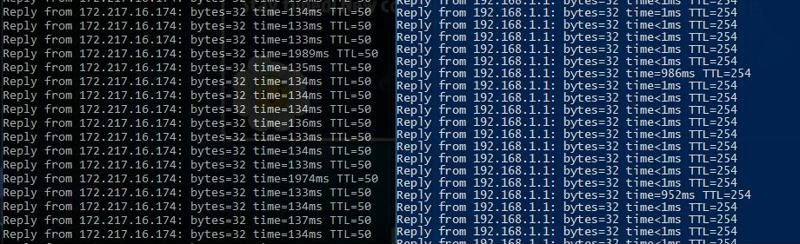

  2. High ping only on PC with WiFi
    Hi
    I have high ping on desktop when i use Wifi for connecting to modem, problem is one month ago my ping with wifi was normal but now is 2000ms (see pic, blue is ping to modem and black is ping to google.com)
    Wifi/Ping issue b899e18e-9c8d-4e0b-bde8-c0346bd4863c.jpg
    i checked this things:
    - at same time ping is normal on laptop over wifi
    - i tried a new wifi adapter card and modem but my ping still is 2000ms
    - i tried reinstalling Drivers.
    and with Ethernet cable ping is normal on desktop but i have to use wifi connection, pls help to fix this weird issue

  3. Kursah Win User
    High Ping when i Turn on the wifi of my laptop
    Can you please provide more information?
    • What make/model of router do you have?
    • Is it on the latest firmware?
    • If you don't know how to do something with your router, please refer to the user's manual or provide us more information about it so we can assist you better.
    • What make/model of laptops do you have?
    • Is the laptop that causes the high latency of the wireless connection much older than the other devices?
    • Have you scanned the device for malware to make sure it isn't causing any kind of attack inside or outside of your network? (I recommend MalwareBytes AntiMalware Free from Ninite.com)
    • What are you pinging when you're monitoring this issue? Google? Your gateway/router?
    High latency in a wireless envirnoment like this one I would assume it is either something overloading from a malicious attack, an old device using a narrower bandwidth causing the router to have to change its channel scopes and having issues doing so (firmware bug), or the router being overloaded trying to manage all the requests over wireless (cheaper home-grade routers can fall flat on their face if too many devices connect to their wireless network(s))...there are other things like channel interference that @remixedcat refers to that are absolutely worth looking into.
    Acrylic WiFi is an excellent program. Run it for about 15 minutes, then use Snip to take a screenshot of it (Google: Now to use Microsoft Snip, if you've never used it). You can attach images to a new post or upload them to Techpowerup.org and past the IMG code in your post.
    Hope this helps get you going in the right direction!
    *Toast :toast:
    Kursah, Sep 11, 2018
  4. Mussels Win User
    Wifi/Ping issue
    Issue with ping spikes
    connect something wired to either router (test both if you can) and do a file transfer. see if the ping spikes get worse.
    if you're wifi bridging/repeating, those tend to cause issues like this if the signal isnt perfect.
    Mussels, Sep 11, 2018
