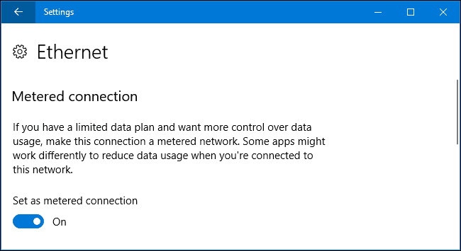

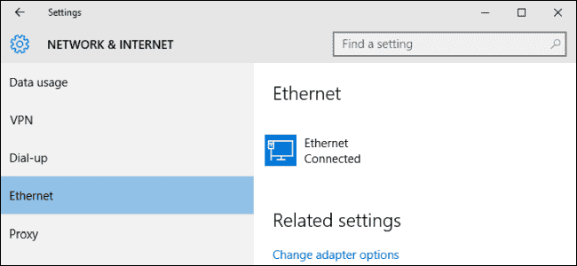

    For some reson my win1 0 is now in public mode and so the network HHD map to my nas drivers don't work any more.
    I google how to change it back to private but when i hit the network connect icon as in..
    Win 10 (1803) stuck in public network mode.. 9d0bd4fd-05dc-47f9-ae12-f341382e9159?upload=true.png
    I get a this..
    Win 10 (1803) stuck in public network mode.. 75a96725-205c-4a8c-b477-91c6739f993a?upload=true.png
    With no option to change to public
    I trying reseting the network.. delting all the driver under network and rebooting and even a reg hack and nothing works

    Method 1: Change the network location using the Settings App.
    • Click on Start.
    • Click on Settings.
    • Click on Network & Internet.
    • Click on Ethernet.
    • Click on the network where you're connected.
    • Turn on the option to Make this PC discoverable. This turns your public network location into a private one.
