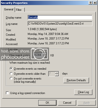

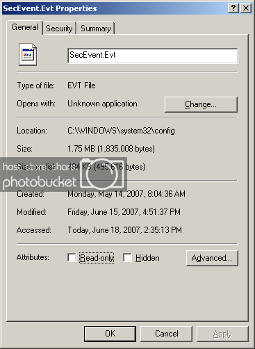

    NTFS Compression on Event Logs
    Anyone ever try doing NTFS compression on their Error Logs?
    It's all text, so it should compress pretty well.
    win10 hang and automatic reboot  ,event log has bugcheck 0x116 NTFSCompressEventLog.png
    win10 hang and automatic reboot  ,event log has bugcheck 0x116 NTFSCompressProperties.png
    Anyone else try this? I suppose it's only useful in server-land when you have huge event logs..
    To compress:
    Run services.msc
    Find Event Log and set to "Disabled"
    Reboot
    Go to c:\windows\system32\config
    NTFS Compress anything that ends in .evt
    Run services.msc
    Find Event Log and set to "Automatic"
    Reboot
