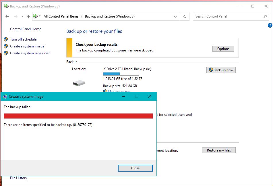

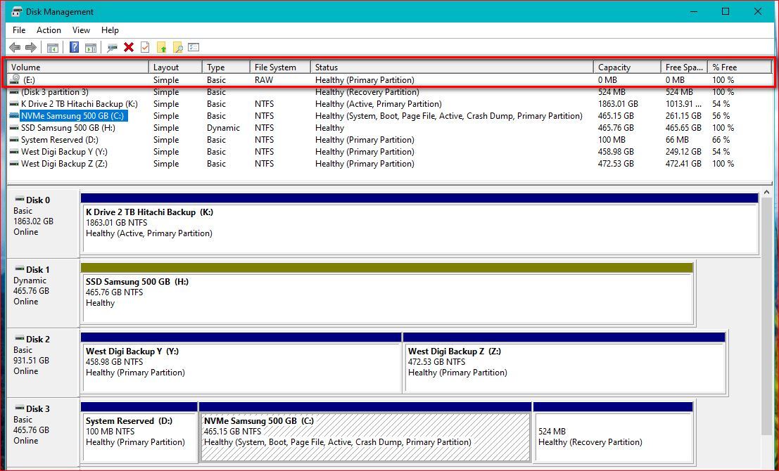

    After a recent mobo/proc/ram upgrade I can no long do a System Image. I get the error "No items specified to be backed up."
    Previously my PC crashed and failed to boot after my attempt to fix this with some partition tool, not sure which or what I did. After recovering the PC starts with a blue screen asking me which Win10 I want to boot. One Win10 fails, the other is totally normal just like it was before the mystery crash and fail to reboot.
    Some illustrative snips.
