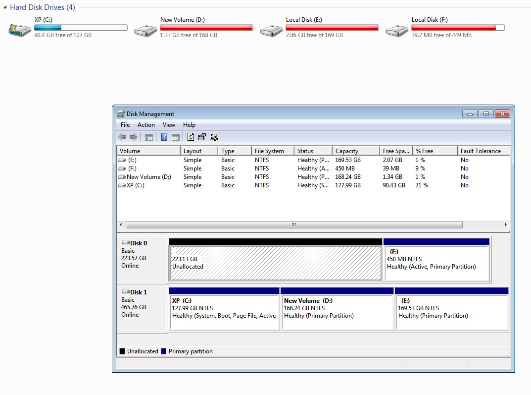

    My Windows 10 desktop PC has a SSD 250GB Sandisk drive with Windows 10 OS on it.
    My computer crashed and I had to turn of by the power.
    When I turned it on it said:
    'Reboot and Select proper Boot device or Insert Boot Media in selected Boot device and press a key'.
    I went into Bios and the HD is detected.... I have installed Windows 7 on another drive and from the desktop am able to gain access to the following information.
    I am hoping the data is still there on 'Drive 0' and that the boot and tables pointing to it need to be rewritten?
    Any ideas on how I can fix so I can get Windows 10 to boot again?
    Thanks for any help / advice,
    Ian
    Drive Information:
    Window 10 Won't boot - Says No Boot Device - Partition gone (unallocated) 3bb2accb-e79e-4f3d-a0fc-e74bc4bff615?upload=true.jpg Window 10 Won't boot - Says No Boot Device - Partition gone (unallocated) fdc78250-9cc8-403c-a286-4a873b6a6cdf?upload=true.jpg
    Ian2211, Jun 26, 2019

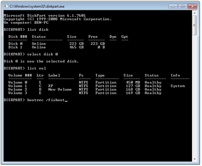

    As I am able to boot Windows installation from USB, I tried the standard startup repair. It said it was not able to fix any problems.
    Next I tried to repair the EFI with Diskpart in the shell:
    • sel vol 1 (note that Diskpart states EFI partition is 'hidden')
    • assign letter=z:
    • cd /d z:\EFI\Microsoft\Boot\
    • bootrec /fixboot
    • bcdboot c:\Windows /l en-us /s vz /f ALL
    It completed all tasks successfully. Unfortunately that did not work.
