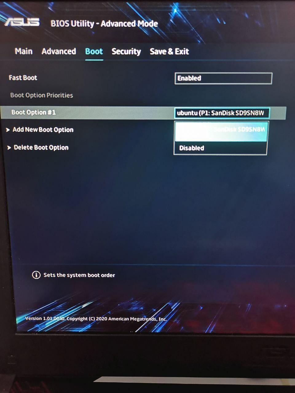

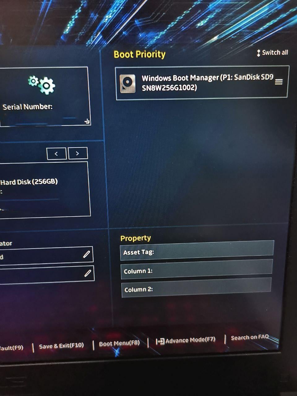

    Hello everyone,
    Please help me with this, appreciate your help!
    My laptop suddenly not able to boot into Window. Everytime when I start up, it will bring me straight to BIOS. I have checked in BIOS that my Window boot option is actually missing and I tried to set the path to boot into Window again.
    However, everytime when I shutdown/restart/hibernate my laptop, the Window boot option will disappear again and I have to set it up all over.
    Is there any other thing that I can do to resolve this issue? I have tried looking up for solution but non of it work for me.
    My Ubuntu is using the same SSD as my Window partition.
    Window Boot manager missing from BIOS d33a3341-8518-4aad-ae74-17403be44f59?upload=true.jpg
    Boot priority with Window Boot Manager​
    Window Boot manager missing from BIOS 337e8d3b-3629-496d-bae9-16c4530b7429?upload=true.jpg ​
    Boot Option with only my Dual Boot Ubuntu​
    Gie34768, Sep 11, 2020
