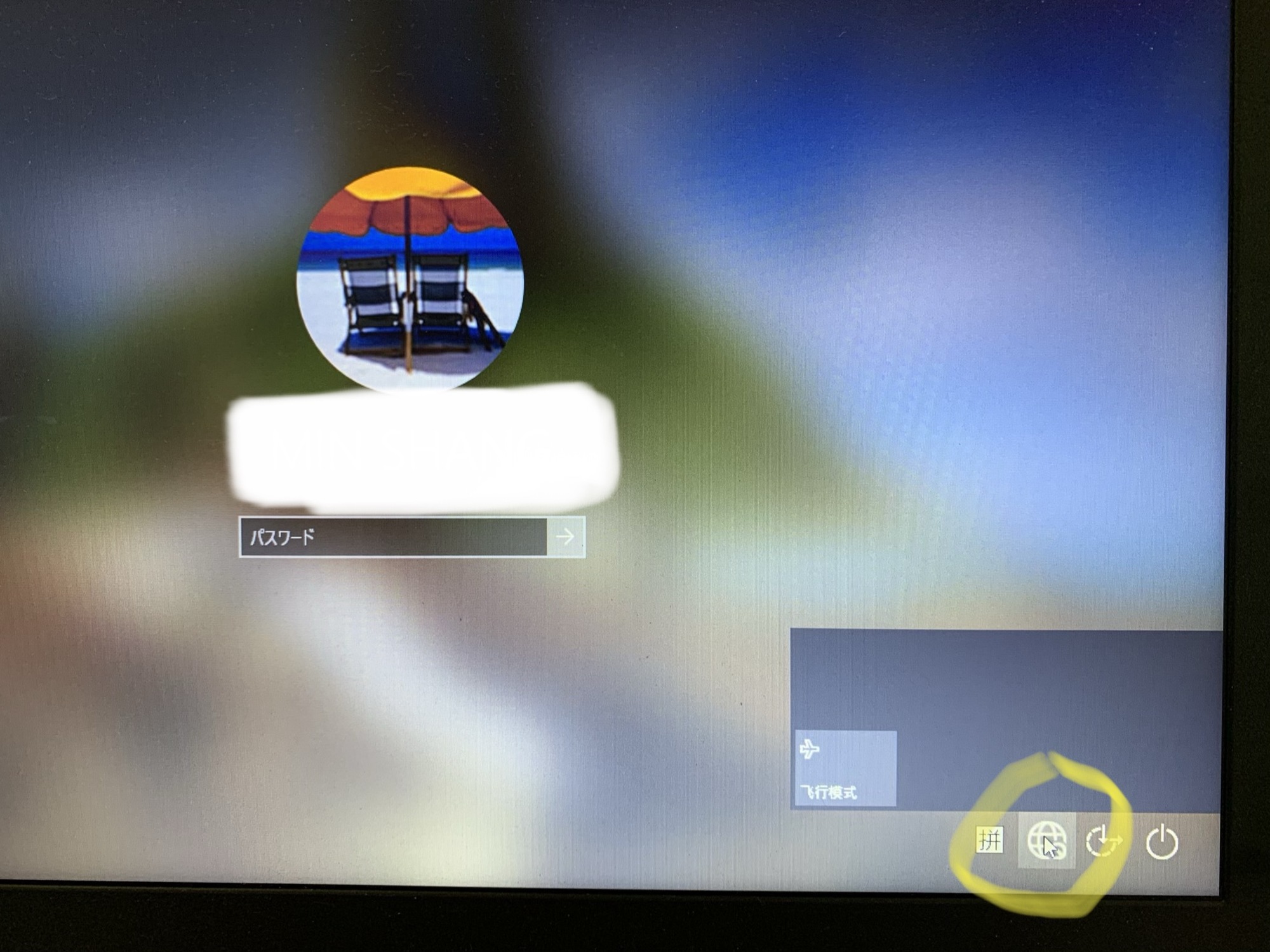

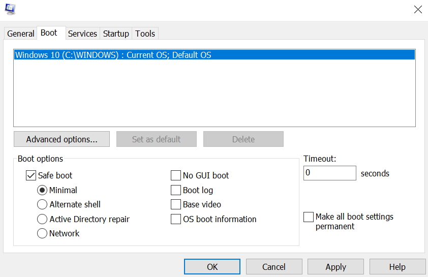

    My mother has been using her windows 10 PC for a long time with everything normal. Recently to speed up the OS reboot, I helped to change Startup options disable unnecessary apps at startup and also changed the Boot-up option to “Safe boot” mode, like the following:
    Window10 cannot login with correct password after changing Boot to "Safe boot" mode 5ad6b528-f1d2-436f-9c1b-8fccfef009ec?upload=true.png
    Somehow after these changes, we could not login to windows 10 anymore with correct password confirmed the password is correct with the eye icon at the right side of the login block. I also tried different input language options, but all failed. Another abnormality is the internet connection at the login page – no internet connection and no way to choose internet setting although the WIFI at my home is normal. I also tried to plug in internet wire cable directly to the laptop, still no internet connection. The login page is like the following:
    Window10 cannot login with correct password after changing Boot to "Safe boot" mode 49dce4a6-f7ab-42bc-8700-19684d839b65?upload=true.jpg
    The password my mother has been using to login to windows 10 is the same as her Microsoft account PS. I tried the same PS on her Microsoft account, and indeed it works normal. Now my suspicion is 1 the “safe boot” mode prevents internet connection at the login page, 2 internet connection is a must for login to windows 10 with Microsoft account. Is this true? If so, how could I fix the issue? Could anybody please help?
    It is urgent since I have to fix the issue before she leaves US in a couple of days. Appreciate your help.
    PS. I tried to login with safe mode, but it still asks for password which I failed to move further.

    To exit from Safe mode follow the steps below:
    • Open Run command by pressing Windows key + R
      on the keyboard and type msconfig in the command box.
    • Under Boot tab uncheck the Safe boot
      option.
    • Reboot the system and check if the changes are effective.
