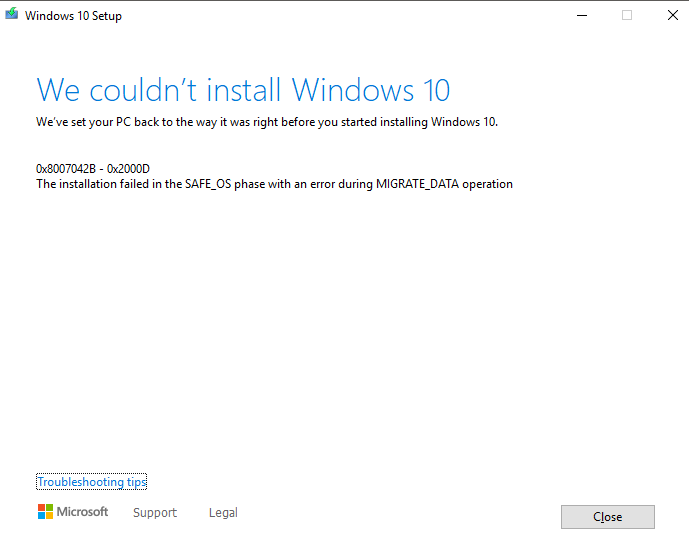

    I have been trying to update my laptop for last few weeks and keep getting the same error.
    Laptop
    • HP Pavilion G6-1384ea
    • Currently Have windows 10 home 1803
    • 8GB RAM
    • F.66 Bios (latest)
    • 1TB SSD - 50% free
    I keep getting following errors:
    Windows 10 1803 to 1903 (0x8007042B - 0x2000D) -  please help df1dcbd3-1cda-4f46-990b-0c28a191ee85?upload=true.png
    What I have done so far
    • Tried installation from ISO
    • disconnected all external USB,mouse, keyword etc
    • Ran CCcleaner to fix all registry errors
    • Ran sfc/scannow and DSIM restore health --- no issues found
    • Clean boot with no services running
    • Disabled system restore
    • Not running any security or firewall apart from windows standard
    I have pretty much tried everything and still it fails with same error.
    SetupDiag shows the following:
    Error: SetupDiag reports fatal migration plug-in failure.
    Last Phase: Safe OS
    Last Operation
    : Offline portion of first and oobe boot apply operations
    Plug
    -in Name = %windir%\system32\migration\SxsMigPlugin.dll
    Migration Operation
    = IPostApply->PostApply
    Plug-in Error: 0x00000002
