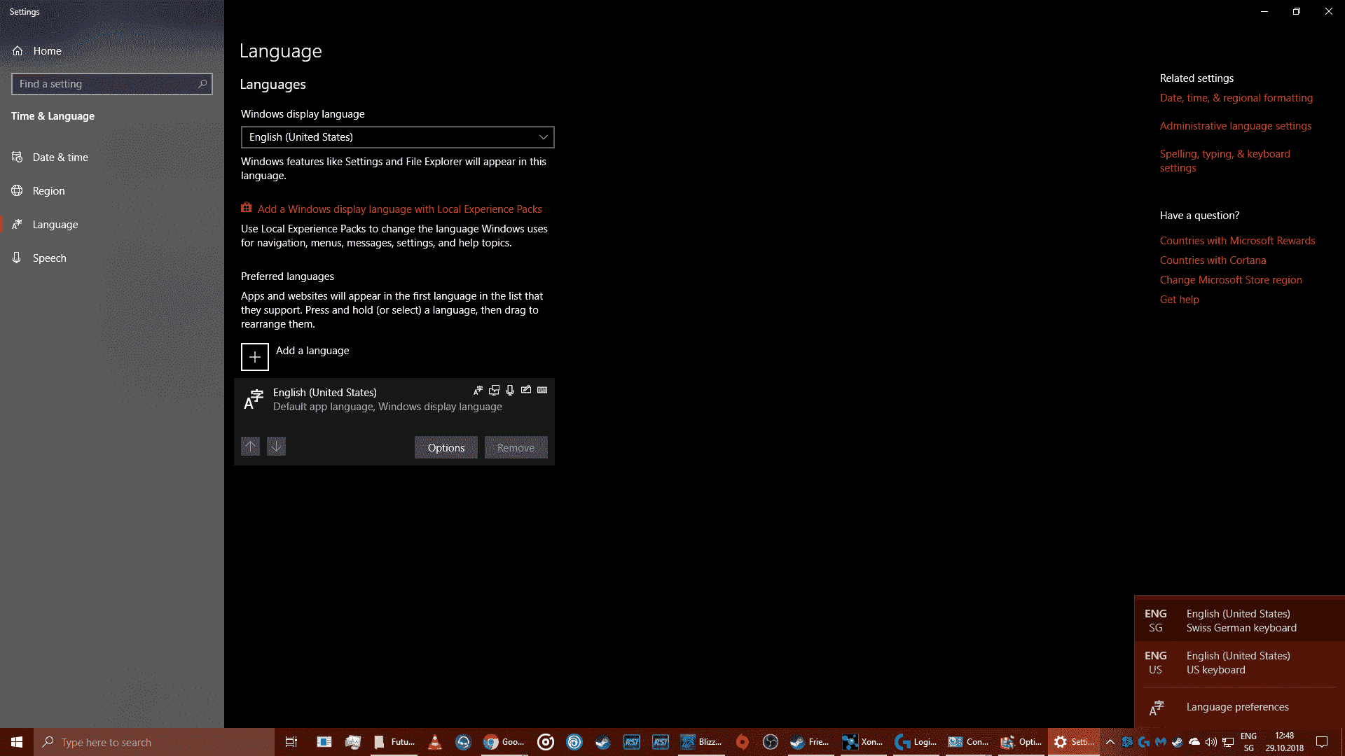

    Hi
    I need your help please. I would like to remove a keyboard language, as it sometimes automatically switches to it, namely CS:GO and Overwatch. I don't want that ; suddenly keys don't work and when I type something a few keys are different.
    It installed with CS:GO - without my consent and it also switches keyboard ingame without my consent.
    [Windows 10 1809] Remove keyboard input language d0670248-0126-4849-8969-23049e632eee?upload=true.png
    I want to get rid of ENG US but ofc keep ENG SG, and yes I prefer English display language, but Swiss Date & Time and Swiss Keyboard layout.
    Best would be if applications are NOT allowed to install keyboard layouts without my consent at all.
    Exact Windows version is:
    Windows 10 Pro 1809, 17763.55 (up to date, targeted branch)
    Thanks for any help
    Neuer31, Oct 29, 2018

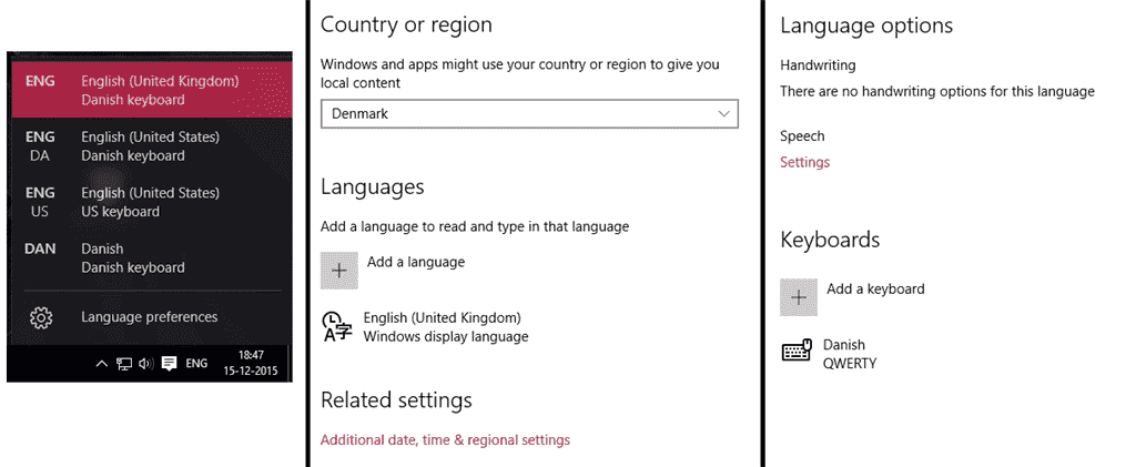

  4. [Windows 10 1809] Remove keyboard input language
    How to remove keyboard and language inputs that aren't listed in settings? [SOLVED]
    I just did a fresh install of Windows 10 Pro N x64 and found that there are a number of keyboard inputs populating the list that I haven't added at any point (see attached image). During the install, I set the following options:
    Language to install: English (UK)
    Time and currency format: Danish
    Keyboard or input method: Danish
    Since I'm living in Denmark and have a Danish layout on my keyboard it made sense to me to have everything but the language of the OS set for Danish. What I don't understand is why that prompted Windows to give me 4 different inputs. Furthermore, the only
    language listed in the option menu is English and the only keyboard input method is Danish QWERTY.
    Of the 4 inputs listed, I only wish to keep the top one. Where do the other 3 inputs come from and how to I remove them?
    EDIT:
    Found solution in other thread on the forum
    Simply add the languages and/or keyboard inputs that are mistakenly appearing and then remove them again.
    [Windows 10 1809] Remove keyboard input language 050689cb-d726-428e-a3df-517036f69672.png
    morten7720, Oct 29, 2018
