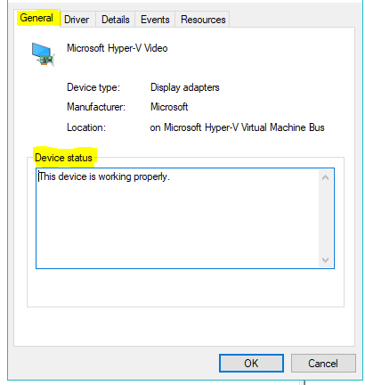

    If we still have the problem, it is recommended to right click on Radeon RX 570 Series->Select Properties->General->If there is any error information in Device status, if there is some error message, we can try to resolve it according to the error message.
    Windows 10 1903 BSOD Apparently Due to Radeon RX 570 Graphics Card hK4sv.png
    Daisy Zhou, Sep 3, 2019
