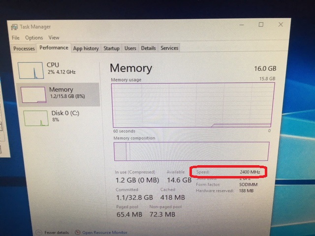

    After updating from windows 10 1809 to 1903, the task manager shows wrong memory speed as 2133Mhz. Earlier it used to show 2400 Mhz. Also, after updating to windows 10 1903, the was rapid and sudden spikes in RAM usage, like rapid ups and downs. After reboot, the system stays stable for 2 to 5 minutes but suddenly the error continues.
    Windows 10 1903 causing Memory leaks and task manager showing wrong RAM speed. 2532fe50-b80b-4594-8692-5206ed180e48?upload=true.png
    Earlier in windows 10 1809, the speed showed as 2400Mhz
    Rohit Rahman, May 30, 2019

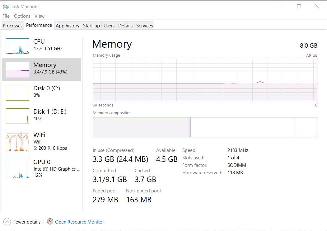

  3. Memory speed might be wrong in Task Manager
    I guess the speed is from Speed of SMBIOS Type 17, but Speed of SMBIOS Type 17 Identifies the
    maximum capable speed of the
    device, but I think we shoud get from Configured Memory Clock Speed of SMBIOS Type 17, it's the configured clock speed to the memory
    device.
    If there are two memory slots in my system,
    I plug 2400MHz in the slot 1 and 2166 in the slot2, the memory speed shows 2166MHz in Task Manager.
    I plug 2166MHz in the slot 1 and 2400 in the slot2, the memory speed shows 2400MHz in Task Manager.
    Microsoft shows the memory speed which is from the speed (Identifies the maximum capable speed of the device) of the
    last SMBIOS Type 17 Memory Device.
    Windows 10 1903 causing Memory leaks and task manager showing wrong RAM speed. 5cf62451-6ad8-48d6-8dd7-24b28c28719b?upload=true.jpg
    Thanks
    WilsonLee512, May 30, 2019
