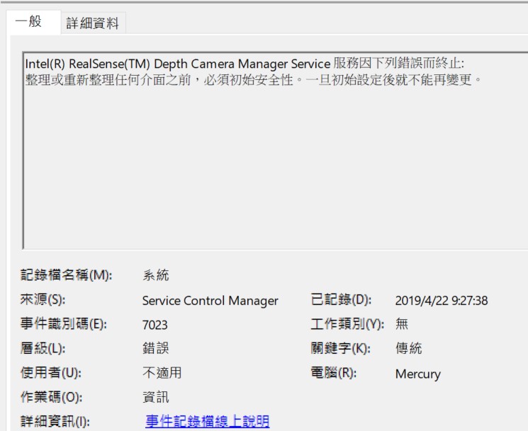

    It looks that the service of Intel RealSense "RealSenseDCM" can't start successfully.
    There is error event 7023 of "Service Control Manager" in event viewer.

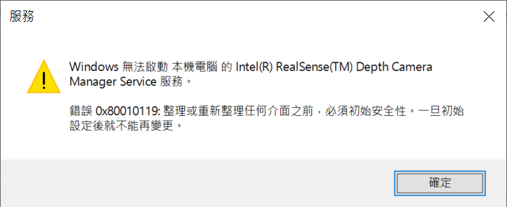

    If try to start the service manually, it will show an error dialog with error code 0x80010119.
    Windows 10 1903 Intel RealSeanse F200 issues 37012966-07a7-40da-8b0a-4dab7aa4a1cb?upload=true.png
    The error message in English is "Security must be initialized before any interfaces are marshalled or unmarshalled. It cannot be changed once initialized".
