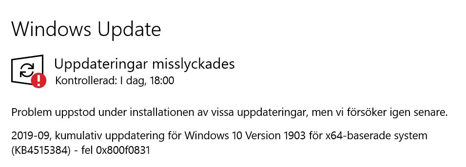

  2. KB4515384 error 0x800f0831
    Hi. I have done several attempts to install the update KB 4515384 but it will not work. I'm always receiving the error code 0x800f0831.
    (2019-09, kumulativ uppdatering för Windows 10 version 1903 för x64-baserade system (KB4515384 - fel 0x800f0831)
    The download seems to work correctly and also the installation seems to work as it should, it take time and I can see the % increasing and also reach 100 % but then the error message occur
    Windows 10 1903 Update 2019-12 Error 0x800f0831 d10aff2c-05eb-4bdd-a2a3-6a42878f84ac?upload=true.jpg
    What to do?
    AurvandilVIP, Jan 3, 2020
