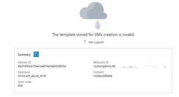

    WVD Spring 2020 Session Host creation error
    Hi everyone,
    Recently tried provisioning a new workspace and host pool - no issue. In a separate step wanted to add a new session host but getting a "The template stored for VM's creation is invalid".
    Never seen that before.
    New desktop.virtualization service is registered in the subscription. RBAC role on RG's and resources are inherited top down and doing provisioning with CREATOR role. We're still in the process of enabling the proper FW rules as per MS Requirements.
    Anybody who can shine some light on this? I've deployed a few successful WVD environments before with WVD Fall 2019 and in my lab had no issues with Spring 2020 issue thus far. But this is for a client and like I said haven't come accross this before
    Windows 10 2004 Multi-Session - WVD 32687fc0-5902-49af-a329-ddf95980e8a0?upload=true.jpg
    WVZee, Sep 8, 2020
