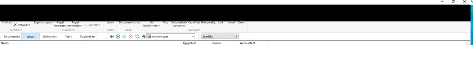

  4. Windows 10 2004 RDS/RDP issue
    RDS 2016 screen issue
    I don't know if this is the right place for my question because it's about server RDS 2016.
    We have a RDS 2016 evironment en randomly some client have strange screen issue's, distorted screen in their RDS session. People with the problems are switching often between application and it looks like screen caching problem. When disconnecting the session
    and reconnect the problem is solved. See screenshow below.
    Windows 10 2004 RDS/RDP issue 6f2c3fb2-e4d0-4e0a-b6e6-4a23b2742c57?upload=true.png
    What have we done:
    * Disabled persistent cache under advanced RDP settings clients.
    * Disabled other settings under advanced RDP settings clients
    * There is nog difference between connecting with thin client or fat client
    Rutger Jan Waringa, Jul 28, 2020
