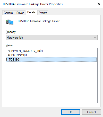

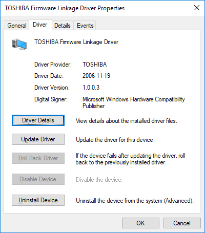

  2. TOS1901 x86 32 bit driver for TOSHIBA Firmware Linkage Driver
    I needed this driver for a 32-bit-only Toshiba Satellite A100 running Windows 10 version 1809. This driver is very hard to find online for a 32-bit device. The device appears as a
    TOSHIBA Firmware Linkage Driver after it has been successfully installed in Device Manager.
    To install the missing driver for this device in Windows 10 32-bit, install the linked driver for TOSHIBA HW Setup Utility, which was
    found at the Canadian Toshiba support website
    http://support.toshiba.ca/support/isg/drivers/common/win7upgrade/143852_22.56.38.TC50039400B.exe
    Windows 10 32 bit drivers for Toshiba laptop P205-S6267 282d8b94-328c-48bc-b863-94cbf426cf33?upload=true.png
    Windows 10 32 bit drivers for Toshiba laptop P205-S6267 60ec5b22-255a-47e5-8725-c6852a937e54?upload=true.png
    Don Cuthbert, May 17, 2019
