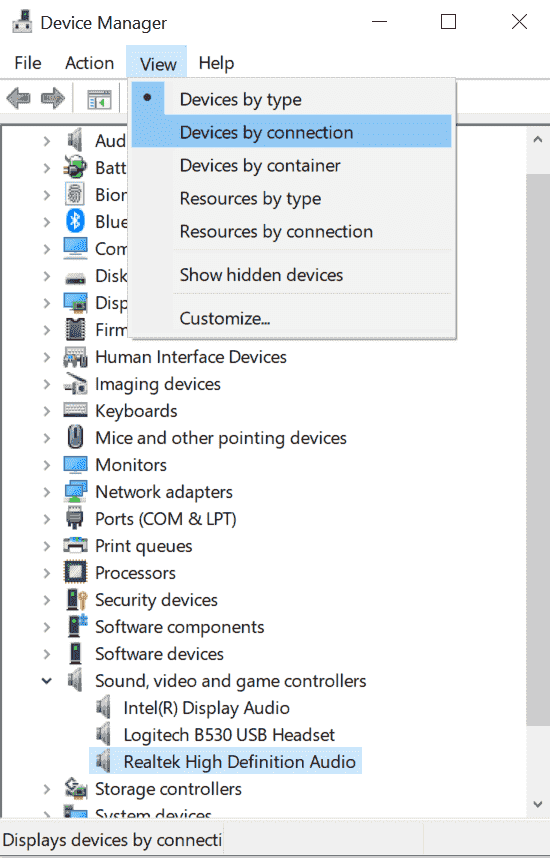

    1. From the Start menu, type Device Manager in the search box. Select Device Manager from the search results.
    2. Find and expand Sound, video, and game controllers.
    3. Look for a Realtek device, or a device that has a yellow triangle with an exclamation point.
    4. Click on the device to select it.
    5. Go to the Device Manager View menu, and then select Devices by connection.
      Windows 10 audio stops working after installing Intel Smart Sound Technology driver... 048ccab5-e448-412c-b600-b4b3aea9fe18?upload=true.png
