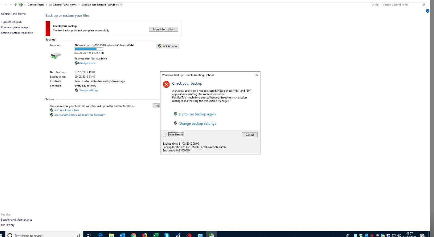

    I have started to receive Below Mentioned error. I have checked on Application log that points to storage space issue on device ( NAS drive). Infect Device has more than Enough space to store windows backup.
    Windows 10 Backup Error -"A shadow copy could not be created. Please check 'VSS' and 'SPP'... 6527262c-48cb-40c5-94b5-40723dff737e?upload=true.jpg
    SumitTank, May 31, 2019
