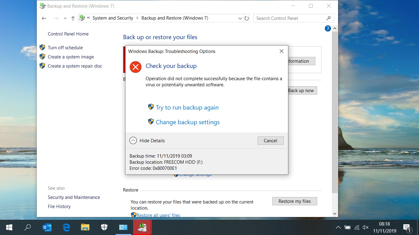

    I recently ran a Windows 10 backup using 'Backup and restore (Windows 7)'. I have successfully used this facility many times using an external Freecom disk to store the backup but this time the backup failed with error code 0x800700E1 (see below).
    Windows 10 Backup Failure 0x800700E1 ec572742-1d46-42bd-9e45-07969507acdf?upload=true.jpg

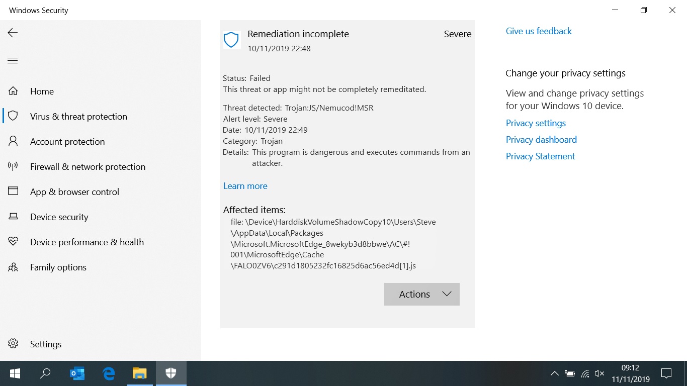

    I then ran a scan using Windows Defender and received amessage that a Trojan had been detected (see below).
    Windows 10 Backup Failure 0x800700E1 ac87f973-d40d-48fa-8863-63c1d2609e5d?upload=true.jpg
    I wasn't sure if this meant there was a virus on my C: drive or on my external Freecom drive. So, I ran a Windows Defender scan and a Malwarebytes scan on my C: drive but they found nothing. I then deleted the backup that was already on my external Freecom disk and re-ran the backup. This time it completed successfully.
    Please would anynone be able to advise if I should do anything else ?
    Thanks, Steve
