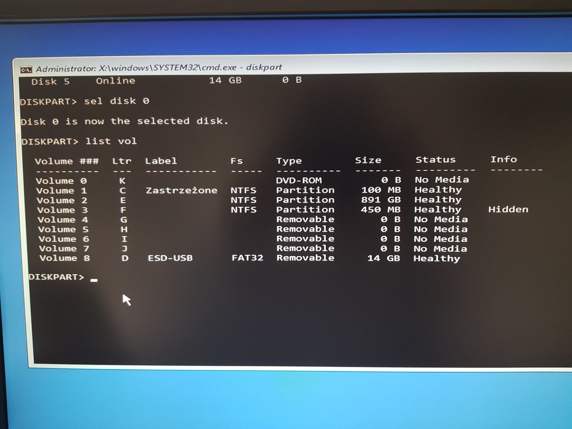

    Windows 10 bootrec /fixboot access denied
    I have a problem, i uninstalled ubuntu with GRUB recently and wanted to fix windows bootloader. And when i type bootrec /fixmbr everything's fine, but when i type bootrec /fixboot it shows access denied. I've read answear to this question
    https://answers.microsoft.com/en-us/windows/forum/windows_10-update/windows-10-bootrec-fixboot-access-is-denied/747c4180-7ff3-4bc2-b6cc-81e572d546df
    , but when i list volumes in diskpart i don't see any fat32 partition so i don't know which partition is
    efi. I see following partitions. Does somebody know a solution?
    Windows 10 "bootrec /fixboot" fails with "Access is Denied" on Multiboot System a25a029b-2fe5-4a38-aa3d-6ac02a718cea?upload=true.jpg
