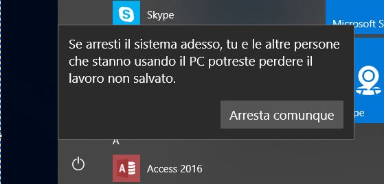

    Just to know: someone gets this problem in pair with following one? When I shut down the computer, appears a message alert saying that "If you shut down the system now, you and other people using the PC may lose unsaved work.":
    Windows 10 Bug: Task Manager not showing processes and Logged users when shut down 42a08a07-26e3-445e-a7f7-54b41cae451d?upload=true.jpg
    Annoying thing is that *user list on task manager is empty* too, letting me think about a malware, root kit or something similar (I use windows defender anyway and various virus scanners did not report anything).

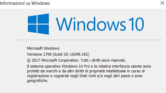

    All above lets me think of a bug in "Fall creators update", this problem arised since I updated my machine to this version:
    Windows 10 Bug: Task Manager not showing processes and Logged users when shut down 02f71aca-2e50-4c69-9f9e-e90f6c1cb594?upload=true.jpg
    It would be glad if someone could address the issues above (without saying about formatting or clean installations..).
