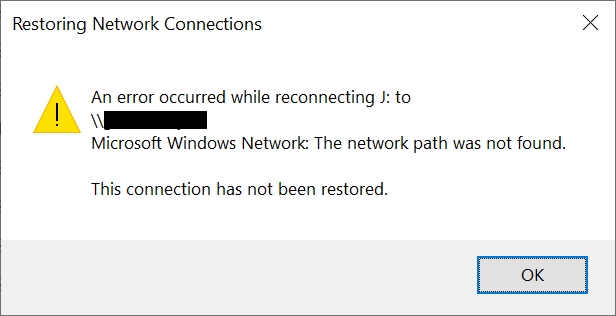

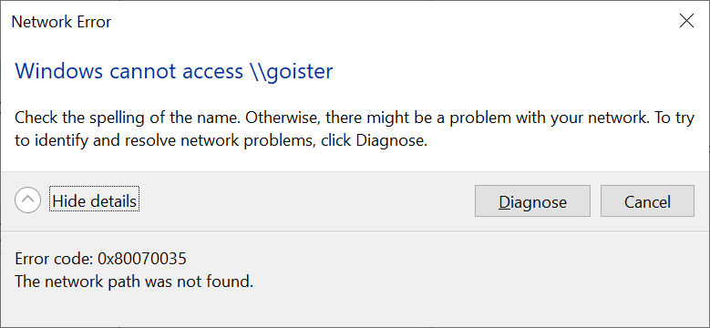

    Unable to access NAS from Windows 10 PC
    I have a Synology DS218J on SMB. I have been able to access it via Windows Explorer with \\hostname just fine, but since a few days ago it no longer works. I get the following error message when I try to access
    a mapped drive within the NAS

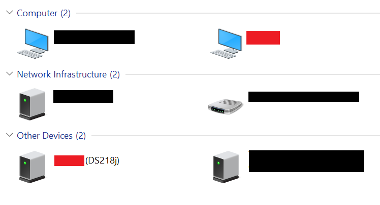

    I can see the NAS hostname (in red below) when I view my network in Explorer
    Windows 10 can't access NAS disk via hostname d6db4706-4e53-4c6c-8e65-fdbf78681280?upload=true.png
    The Synology web portal works fine. I'm able to access it on my web browser. I'm also able to ping it just fine. I'm also able to access it on my Android device using the DS file app. However, I can't access
    it via Windows Explorer either via \\hostname or \\ipaddress.
    I tried net use * /delete and then manually add the NAS root or the shared folders. Here are the results:
    "net use X: \\hostname or IP address" - The network path was not found.
    "net use X: \\hostname or IP address\SharedFolder" - System error 1790 has occurred. The network logon failed.
    If I try the above net use command again, I'll get "System error 59 has occurred. An unexpected network error occurred."
