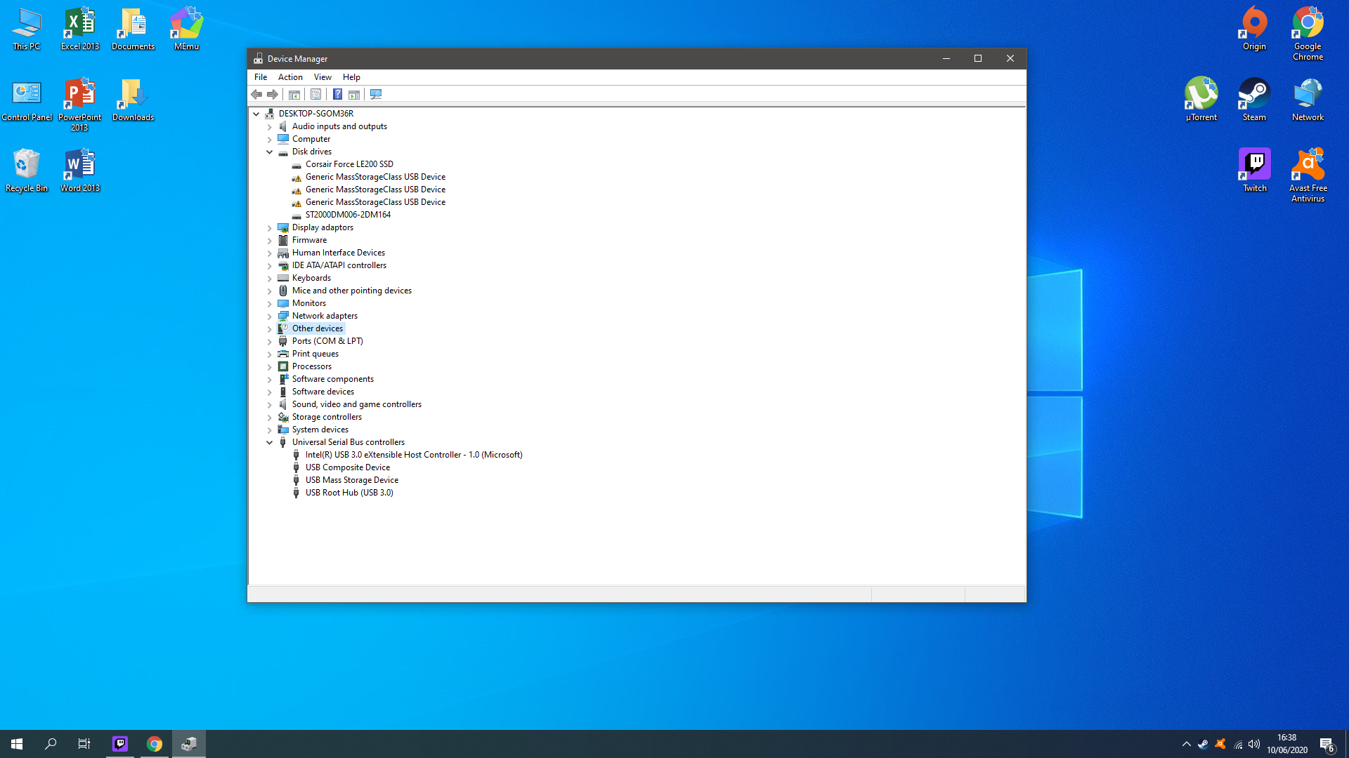

    I'm having trouble getting windows 10 to recognise my SD card reader. It finds the reader itself with no issues, installing it under device manager as a USB Mass Storage Device. However, it doesnt install the drivers for the SD card slots in the disk drive part. When I try to update them both automatically and manually, it says it found the drivers but couldn't install them, and access was denied
    Windows 10 cant install drivers for USB mass storage device [​IMG]
    Windows 10 cant install drivers for USB mass storage device a9a6bd4d-8ad5-405a-9f43-e8e4b93627c7?upload=true.png
    I have tried resetting windows 10, which did work for a while, but once it had updated, it stopped working again. The device works fine on another PC, it just seems to be this one. Any help would be great

    We would like to know the additional information to better assist you with USB mass storage concern. Kindly answer the following questions below:
    • Do yo have an updated Windows 10 on your computer?
    • What are the troubleshooting steps you've done so far after your media player stopped recognizing the portable drive?
    • Do you have the updated USB driver on the current operating system that you are using?
    We are looking forward to your response.
    Regards.
    Ma. Lau, Jun 15, 2020

    Hello Ma. Lau:
    Thank you for the reply.
    Please see my answers below.
    • Yes, I have an updated Windows 10 on my computer.
    • I have been trying to google the solutions and these past couple days I have been trying to update my device driver in Device Manager. However, none of the item under "disk drive" or "storage controllers" has the option to update the drive to "USB mass
      storage device". I also tried to update the driver by pointing the update path to "C:\Windows\System32\DriverStore\FileRepository" but still can't seem to fix it.
    • I am not sure if I have the updated USB driver on my Windows 10 PC. When I checked the USB controller under Device Manager, it says the software for the device is up to date.
    Thanks again for the help!
    KevH123, Jun 15, 2020
