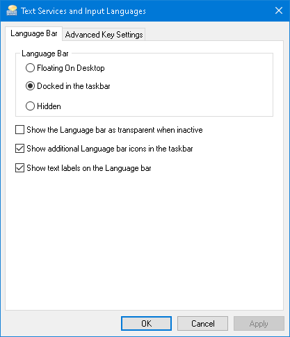

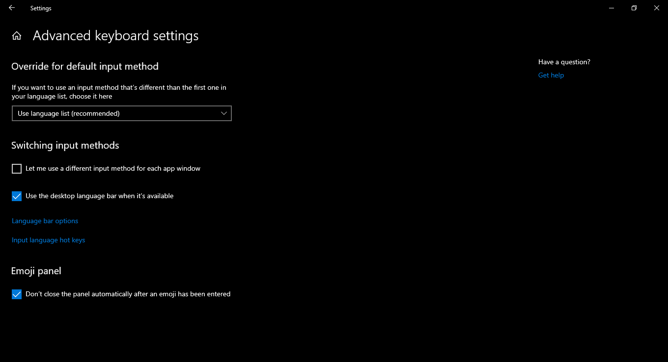

    Then I checked Settings\Devices\Typing\Advanced keyboard settings and its subsection, Language bar options, below are screenshots of these two, also no fault.
    Windows 10 Chinese Input Method not working 35e0ee5d-0ce5-48ff-a90d-43ae03048a5a?upload=true.png
    Windows 10 Chinese Input Method not working 8e848d5b-c1c1-4954-a7fc-9a02c55a8972?upload=true.png

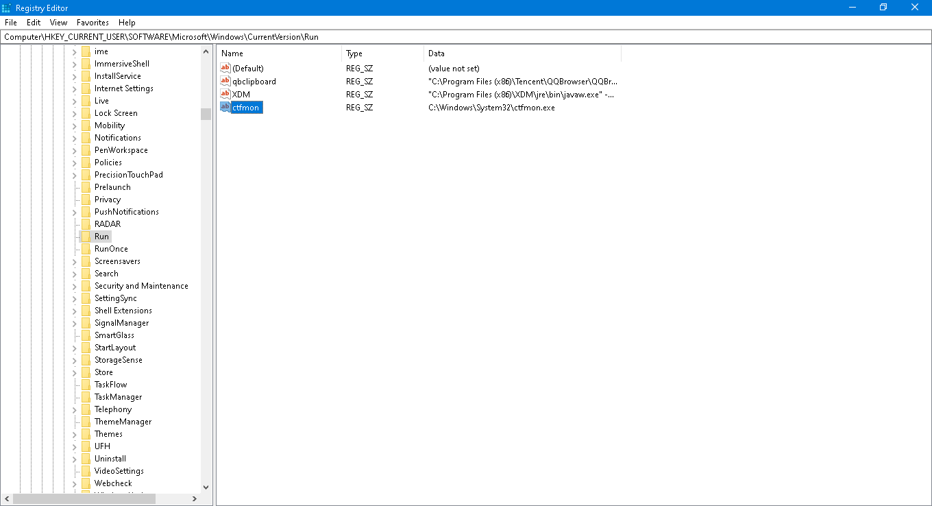

    Then I ran ctfmon.exe in Administrator: Command PromptI have Admin CMD pinned to taskbar, then ran regedit and navigated to HKCU\Software\Microsoft\Windows\CurrentVersion\Run and created new string value, below is a screenshot.
    Windows 10 Chinese Input Method not working 20970267-a7f7-4cca-bf61-ba5a1b78d6f7?upload=true.png
    And then I restarted my computer, only to find the problem still haven't been solved.

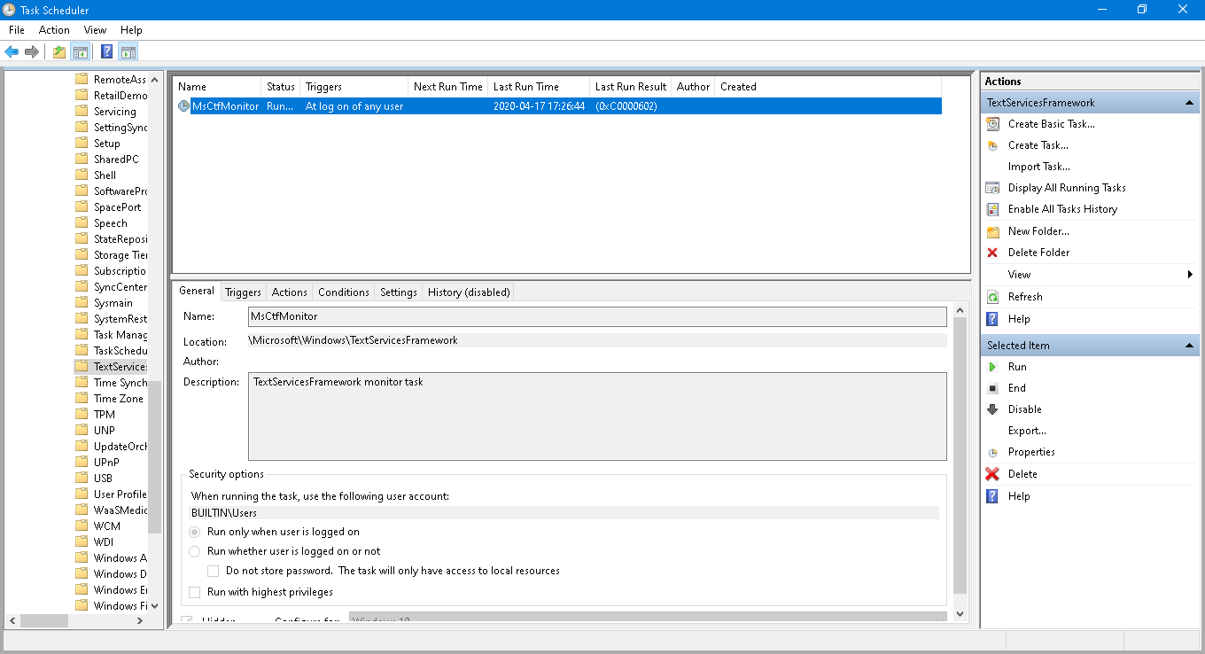

    I then ran taskschd.msc Task Scheduler, navigated to Microsoft\Windows\TextServicesFramework, and checked MsCtfMonitor, which was not running, and then I started it, and I can type in UWP apps again after switched into Chinese, below is a screenshot of taskschd.
    Windows 10 Chinese Input Method not working a47da813-9f2d-4b85-a307-2cfa5ffc1bf3?upload=true.png
    And then I can easily switch into Chinese input methods without any problem, but still I just can't type Chinse at all, I can only type English when I switched into Chinese input methods no matter what, and when I use Microsoft Pinyin IM, I can't switch between Chinese and English, I can only type English, I hover my pointer over Ying, it tells me IME is disabled:

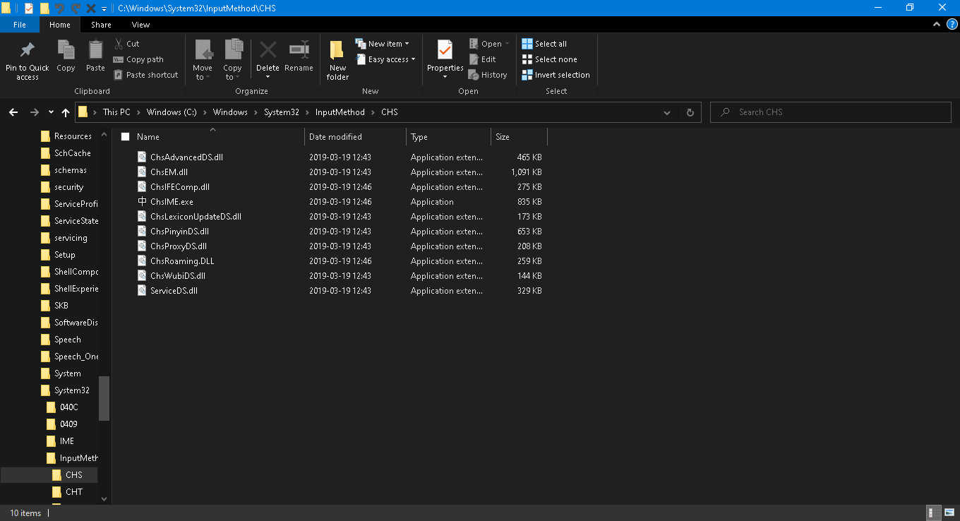

    In fact I have actually managed to locate the troubling Microsoft IME, it is in %windir%\system32\inputmethod\chs, its real name is ChsIME.exe, below is a screenshot of this folder.
    Windows 10 Chinese Input Method not working be91d2ab-63cc-4f39-a6ea-9566e6b431e6?upload=true.png
    I then tried to start it manually but I can't, it is impossible. And I knew even if I could, it would make Input Indicator disappear.

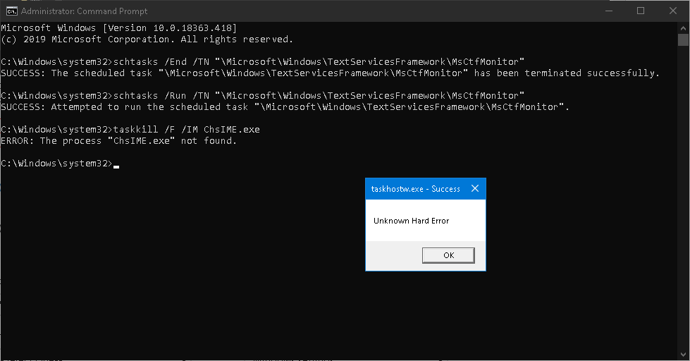

    so I restarted and ran the following commands:
    schtasks /End /TN “\Microsoft\Windows\TextServicesFramework\MsCtfMonitor”
    schtasks /Run /TN “\Microsoft\Windows\TextServicesFramework\MsCtfMonitor”
    taskkill /F /IM ChsIME.exe
    And an error warning window always popped up, sometimes it says "taskhostw.exe unknown hard error", other times it says "taskhostw.exe a fail fast exception has occurred..."
    Windows 10 Chinese Input Method not working 5d3b4aca-beb5-4371-ba5a-ddd67d182e4c?upload=true.png
    Still problem exists. I have failed to solve it by myself, and I don't want to reinstall or system restore once again, please do not suggest me to do so, avoiding actually solving the problem. Yes, for sure it will work for a time, but it is really just a temporary solution, not a permanent one. The system will only work without any problem for a rather short time, before ultimately the same problems emerge over and over again inevitably.
