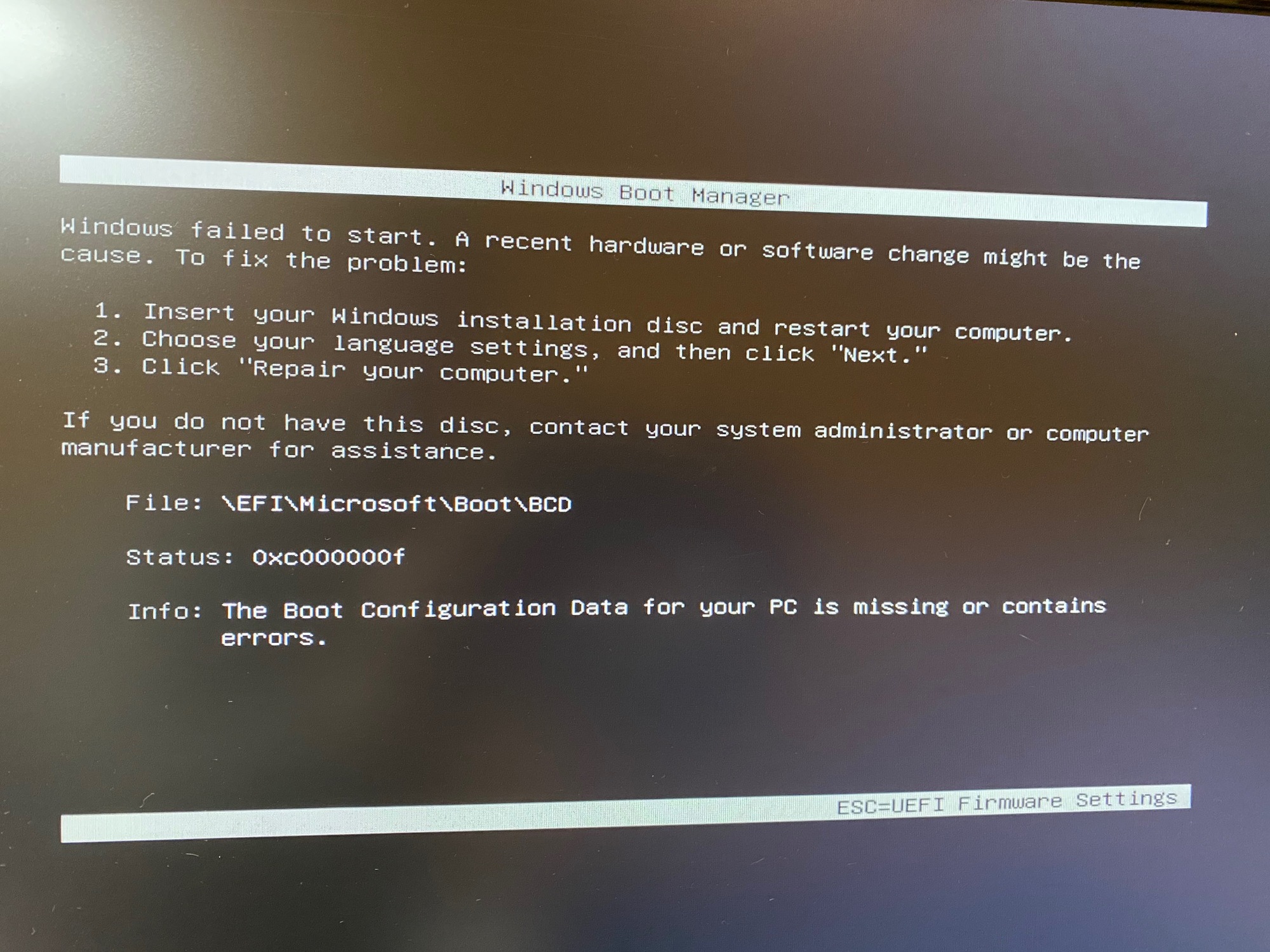

    My computer disk crashed. Initially the PC tried to repair but failed and prompted multiple options for recovery. However, it failed to recover from my backup image. With many trials and errors, I finally got a text mode error message titled "Windows Boot Manager". Please see the attached image. The PC does not recognize my USB recovered disk anymore unless I disconnect the boot hard disk.
    I guess I have to replace the hard disk. However, how do I re-install windows 10 since my backup image did not work? Thanks.
    Windows 10 crash cannot be repaired 947d0713-a502-4b70-af99-4b1222847f42?upload=true.jpg
    NongJin, Jan 11, 2020
