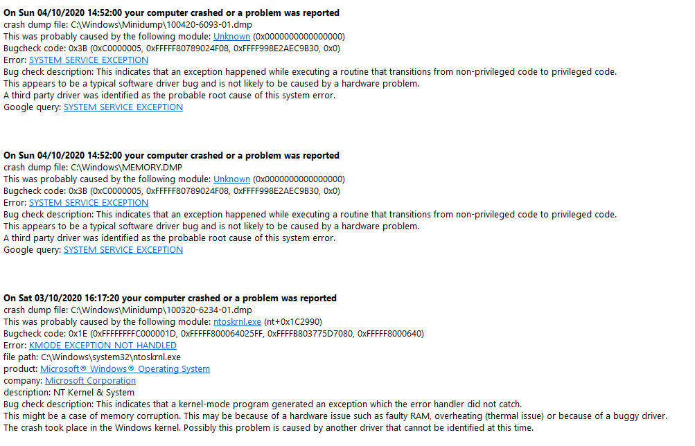

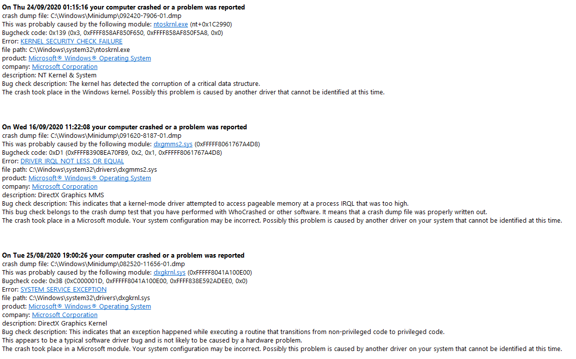

    Hello, since i got my new pre-built PC, its been randomly crashing my games, or just blue screening out of nowhere.
    here is the picture of analyzed minidumps. Windows 10 crashing bluescreens 1bf04cd1-a7d1-48ba-b3cc-9222146ff2bf?upload=true.png Windows 10 crashing bluescreens d02c82b8-b559-4a28-b2a6-ff704d6409a0?upload=true.png

    There are a few things that I notice with these errors, they are nearly all hardware 0x124 errors which are difficult to troubleshoot because there is so little information.
    Most of them occur when the Norton Security process is running so a first step would be to uninstall Norton and just use Windows Defender while we are troubleshooting.
    There was one different BSOD error: 0x18 Reference by Pointer
    Probably caused by : BHDrvx64.sys ( BHDrvx64+114761 )
    You need to update or rollback your Symantec Heuristics Driver. Maybe this is part of the Norton install so it may be removed anyway.
    Check if there has been any improvement and if not then you will need to work through your hardware:
    STOP 0x124 Troubleshooting [/i] Read carefully before proceeding.
