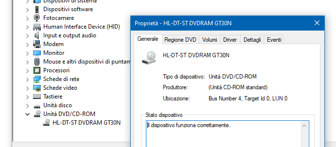

    I found a workaround!
    In Win 10 the CD is not seen the most of the times a CD or DVD is inserted in the tray.
    Something goes wrong with what formerly was Interrupt call that now doesn't seem to work anymore.
    So I tried to make a workaround for every CD I insert!!!
    To trigger the interrupt I have to enter Device Manager right click on Start Butto, open the CD-DVD drive icon, then right clicking on it enter Properties.
    At that point Win10 finally sees the CD!
    So you can keep the Device manager open and every time you load a CD you look for Properties!
    A long turn around isn't?
    Windows 10 doesn't read my CD's 851075f2-3229-4aa2-b9d1-465d9fad13dc?upload=true.png
    code001, Feb 17, 2020
