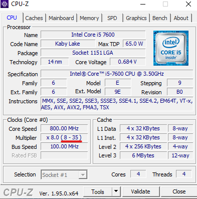

    I swapped my motherboard from GA-B250M-DS3H to GA-B250-HD3P. I turnedon pc and played some games. I felt it is performing worse than before swappingso checked task manager and my CPU is running only at base clocks. I restartedmany times pc and quickly opened task manager, every time CPU ran at turboclocks but after cca 5 seconds it dropped to base clocks. I downloaded CPU-Zwhen I quickly open it after restart it shows multiplier 8x-41x but when I openit after 10 seconds it shows 8x-35x. I also tried Linux and everything wasrunning without problems. My temps were about 50°C 122°F, so definetly not thermal throdling. BIOS is set correctly.
    [COLOR=rgba0, 0, 0, 1]I recovered Windows three times. First time I recovered via drive,after recover I downloaded CPU-Z and showed multiplier 8x-41x, I restarted pcand again 8x-35x. Second time I recovered via cloud. It lasted ten days andthen dropped to base clocks. Third time I recovered via drive it lasted fewturn on/offs and again dropped.[/COLOR]
    Do I have to completly reinstall fresh install Win or changesomething in settings?
