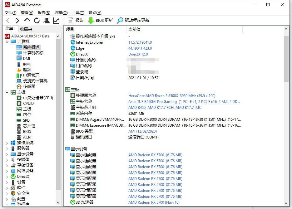

    ,WIN1020H2
    0xc0000428F1WIN10
    0xc0000428UEFIBIOSF10
    BIOS:disablesetup
    windows 10 error code 0xc0000428 "RECOVERY...Your PC/Device needs to be repaired.The... [​IMG] windows 10 error code 0xc0000428 "RECOVERY...Your PC/Device needs to be repaired.The... 32cb3371-879e-4e88-b36a-35126200ab3b?upload=true.png
