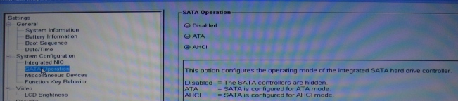

  2. Tryx3 Win User
    Windows Will Not Boot After Trying To Change To AHCI Mode
    I have looked at the How to Enable AHCI in Windows 8 After Installation link you provided.
    [By the way, after you paste in a web address press the spacebar and it will turn into a hyperlink so people can get to where you are pointing -
    http://www.ithinkdiff.com/how-to-enable-ahci-in-windows-8-after-installation/
    All their methods were about steps to take in Windows 8 Registry before changing the BIOS. They were not an alternative to the BIOS. If you have no such setting in your BIOS then you cannot use AHCI. All BIOSes differ but here is a sample AHCI entry to
    help you check for anything similar -
    Windows 10 error - INACCESSIBLE_BOOT_DEVICE trying to change to AHCI mode for mother upgrade 8a967d2a-8dc3-4201-85ac-ceefe8dfb974.jpg
    • I think you should leave any fiddling with AHCI now and focus on getting the system in working condition first though.
    • If SFC & DISM did not help you resolve this problem then I suggest that you restore your system image again.
    • If you no longer have it then make an
      installation USB
      and run a
      Repair install [also called an InPlace upgrade]
    Once you have a working system again & only if you have a ACHI setting in your BIOS -
    • Make a new system image before any more experiments.
    • If you do find an AHCI setting in your BIOS then you could try just changing it and seeing if the system still works. Another user did just that and found that it all continued working without anything else having to be done.
    • And if it doesn't work for your computer then you could
      either go back to the BIOS, reset it then give up the idea or do a clean installation with AHCI set and see if that works.
