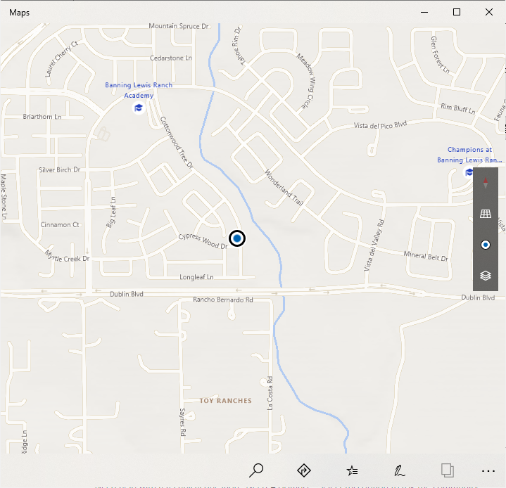

    I have a Windows 10 Enterprise version 2004, build 19041.546 system for which the geolocation services are malfunctioning. The system is in Washington, DC, and the geolocation consistently reports in Colorado Springs, Colorado.
    The problem occurs for all accounts on this system, including Microsoft accounts and local accounts. The problem does not occur for other Windows 10 systems on the same wifi network with the same public IP address. The problem occurs for this system on other wifi networks with different public IP addresses.

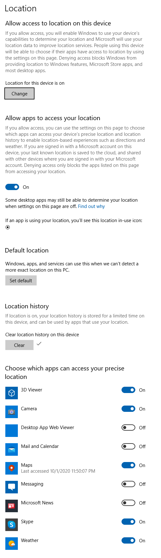

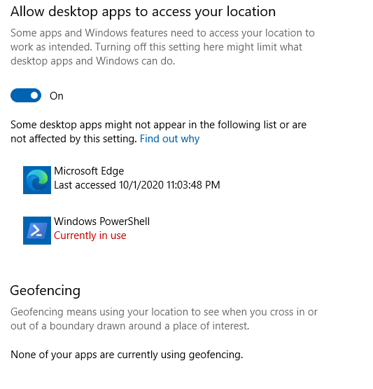

    Location services are turned on. Allow apps to access your location is on. The default location is set accurately to Washington, DC. Allow desktop apps to access your location is on. All updates are installed. I have tried clearing the location history through the location settings menu.

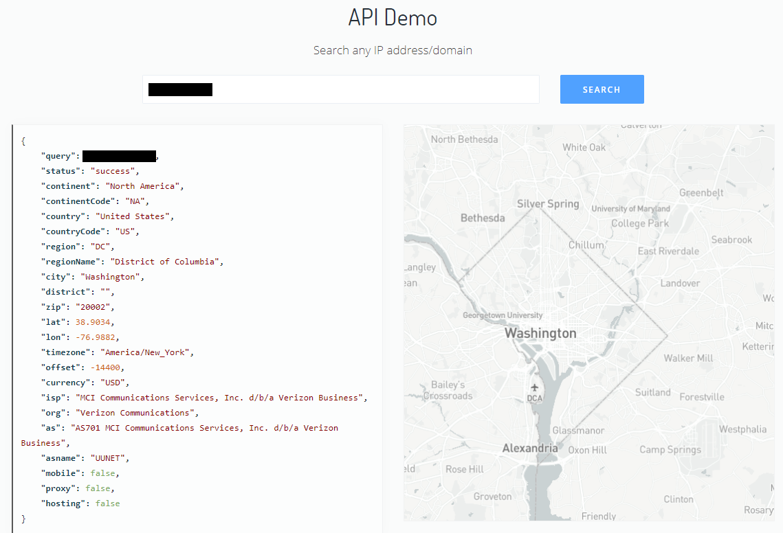

    My IP address geolocation data accurately reflects Washington, DC, as you can see from the below data from ip-api.com
    "query": "xx.xx.xx.xx",
    "status": "success",
    "continent": "North America",
    "continentCode": "NA",
    "country": "United States",
    "countryCode": "US",
    "region": "DC",
    "regionName": "District of Columbia",
    "city": "Washington",
    "district": "",
    "zip": "20002",
    "lat": 38.9034,
    "lon": -76.9882,
    "timezone": "America/New_York",
    "offset": -14400,
    "currency": "USD",
    "isp": "MCI Communications Services, Inc. d/b/a Verizon Business",
    "org": "Verizon Communications",
    "as": "AS701 MCI Communications Services, Inc. d/b/a Verizon Business",
    "asname": "UUNET",
    "mobile": false,
    "proxy": false,
    "hosting": false

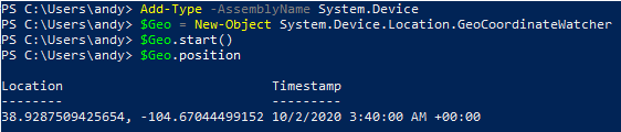

    However, Windows consistently pulls the wrong location as you can see from the PowerShell results below.
    PS C:\Users\andy> Add-Type -AssemblyName System.Device
    PS C:\Users\andy> $Geo = New-Object System.Device.Location.GeoCoordinateWatcher
    PS C:\Users\andy> $Geo.start
    PS C:\Users\andy> $Geo.position
    Location Timestamp
    38.9287509425654, -104.67044499152 10/2/2020 3:40:00 AM +00:00
