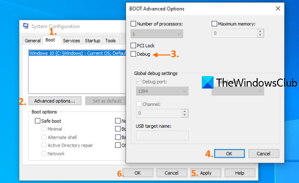

    1] Using System Configuration
    System Configuration tool (or MSConfig) in Windows 10 lets you access and use many important options like startup selection, BOOT Advanced options, disable Microsoft services, etc. It is also helpful in disabling debug mode. Here are the steps:
    1. Click on the Search box of Windows 10
    2. Type msconfig or system configuration
    3. Press Enter key
    4. Access Boot tab in System Configuration window
    5. Uncheck Debug option in BOOT Advanced Options window
    6. Press OK button
    7. Click on Apply button
    8. Click on the OK button
    9. Restart your computer.
    After that, your system should work fine.

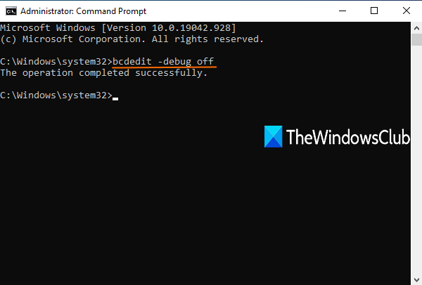

    2] Using Command Prompt
    Follow these steps:
    Run Command Prompt as an administrator
    Execute the following command:
    bcdedit -debug off
    Related: Fix Windows 10 hangs or freezes.
    Now when you will log in to your Windows 10 computer, it shouldn’t hang and the mouse, applications, and other windows should run properly.
