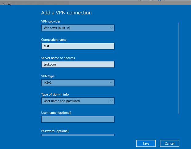

    When I configure a IKEv2 VPN connection using the windows 10 configuration interface:
    Windows 10 IKEv2 VPN connects but does not have internal network access 29156df3-3f9c-462b-8dd0-6d90e6c6f494?upload=true.png

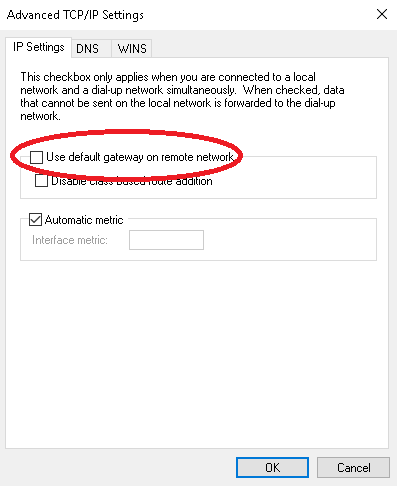

    I can connect to the VPN and access internet connections but I cannot access the internal VPN network, after troubleshooting the problem I realized the issue is the lack of a setting for a gateway, you can find it in: adapter options, properties of the VPN adapter, Networking, IPV4 Properties, Advanced:
    Windows 10 IKEv2 VPN connects but does not have internal network access ad602a80-602a-4a1d-807e-204b31b1daf7?upload=true.png
    If I enable that option I can sucessfully connect to the servers in internal VPN network.

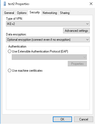

    Then, I made a test creating the VPN using Network and Sharing Center interface, Setup a new connection or network, Connect to a workplace, use my internet connection (VPN) and after creation of the VPN adapter I changed in the security tab, the type from Automatic to IKEv2.
    Windows 10 IKEv2 VPN connects but does not have internal network access 48f659b5-9c06-4c5e-8c8c-033f74476f79?upload=true.png

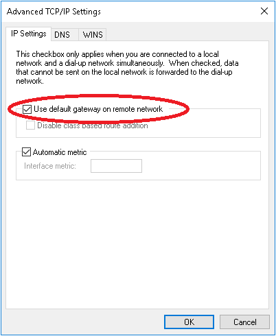

    Finally I checked the gateway option and it was active by default, i havent had to activate it myself:
    Windows 10 IKEv2 VPN connects but does not have internal network access 10cb3fe9-c9d0-4882-86f8-f2e7d20912cf?upload=true.png
    So I realize that the problem is that when you setup a new vpn IKEv2 connection using the windows 10 settings interface it does not enable the "Use default gateway on remote network" option, but that option gets enabled if you set up the IKEv2 VPN using the Network and Sharing Center interface.
    I tried setting up a PPTP type VPN and it got the "Use default gateway on remote network" enabled on both, Windows 10 settings and Network and Sharing center interface. So this problem only happens with IKEv2 type VPN.
