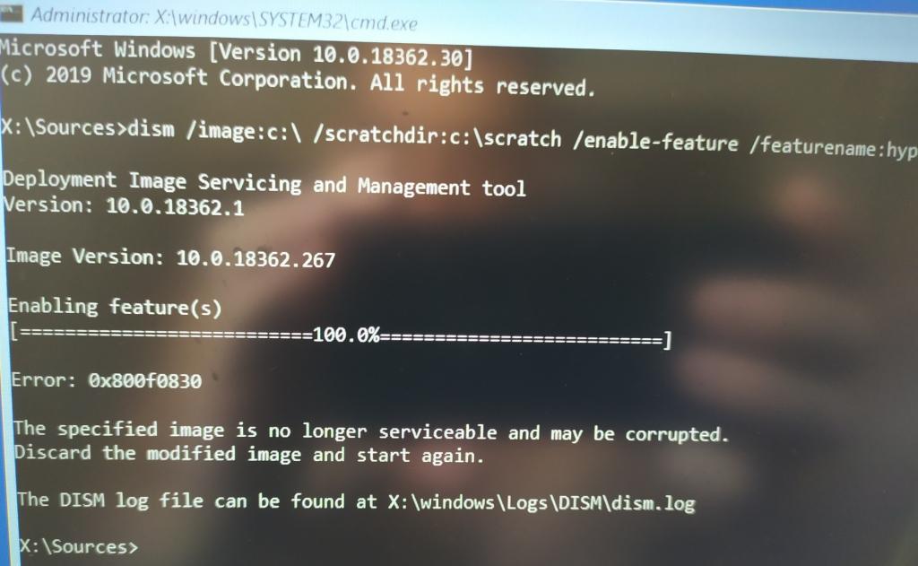

    I went again to recovery command line and tried to install if from there with:
    **dism /image:c:\ /scratchdir:c:\scratch /enable-feature /featurename:hypervisorplatform**
    which gave me error:
    Windows 10 in Asus laptop firmware update or hyper-v causes automatic repair loop everytime 21084a2b-4268-4579-9f87-1fb02671c6cb?upload=true.jpg

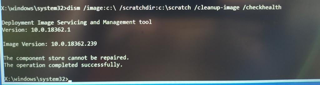

    Then i did a dism checkhealth and i have:
    Windows 10 in Asus laptop firmware update or hyper-v causes automatic repair loop everytime 897fcf4b-48e8-4c71-adbd-6343a0e1973e?upload=true.jpg
    Also, installing VisualStudio i got a warning saying:
    **Package 'Microsoft.VisualStudio.AspNet45.Feature,version=16.0.28315.86' failed to install.
    Search URL
    https://aka.ms/VSSetupErrorReports?q=PackageId=Microsoft.VisualStudio.AspNet45.Feature;PackageAction=Install;ReturnCode=-2146498512
    Details
    Command executed: "C:\Windows\system32\dism.exe" /online /quiet /norestart /Enable-Feature /FeatureName:"netfx4extended-aspnet45" /All /logPath:"C:\Users\mike\AppData\Local\Temp\dd_setup_20190811143007_359_Microsoft.VisualStudio.AspNet45.Feature.log"
    Return code: -2146498512
    Return code details: Unknown error (0x800f0830)**
    So i can work with the system but it seems a bit corrupted.
    Some apps like Boxcryptor are failing to install now.
    Thanks in advance. Any help would be much appreciated.
