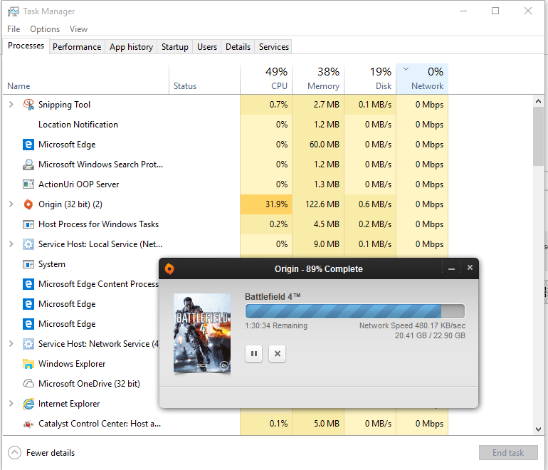

  2. Windows Task Manager showing 0 Mbps network usage
    My task manager is showing 0 Mbps network usage per process (In process tab) despite it saying 2% used for example.

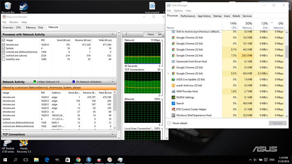

  3. edulmar Win User
    Task manager fail to show network usage
    Windows 10 is not monitoring network usage. Screenshot shows the task manager entry for FF... e9840ae2-fbaf-4391-b1ce-8f4fbe9eecc3.jpg
    Recently
    my Windows 10 has update itself. During the windows updating process (downloading), I realize the Task Manager>Performance showing network data usage but on Task Manager>Processes showing 0% network usage. Now even after the updating process complete, the
    Task Manager>Processes still showing 0% network usage.
    I check Resource Monitor and it show details of the networks usage but it state"Filtered by svchost.exe(NetworkService),System"
    Is there any method to solve this problem? Is there any tendency that Windows has installed malicious program or virus during the update? Becoz in the current state, everything the Windows 10 doing at background is completely invisible. Almost every minutes
    Resource Monitor shows svchost.exe(NetworkService) & System are sending and receiving data. It make me feel suspicious, why the Windows have to cover all it trace if it just doing regular updating process and why should it constantly communicate (sending &
    receiving data) if it already finish the updating process?
    edulmar, Apr 10, 2021

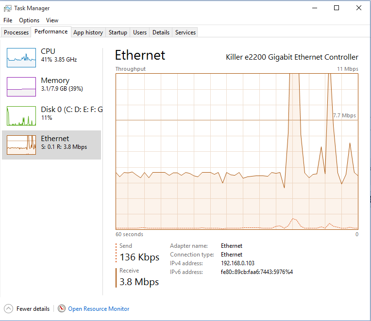

    Windows 10 Task Manager Not Showing Network Usage?
    Since you have Gigabit Ethernet, the percentage upto 1 decimal place would still be zero. Since that is what is used for sorting as well, you end up with all apps showing 0.0%.
