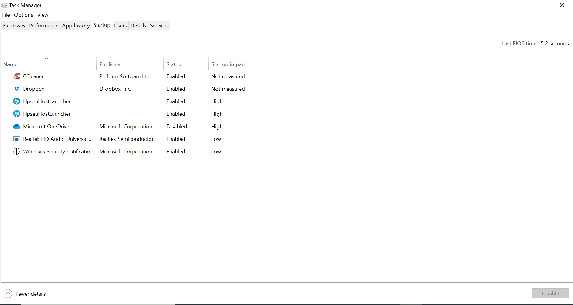

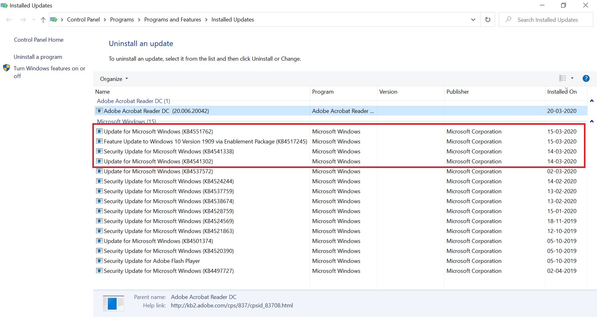

    I had installed updates for windows 10 on the 14th & 15th of March respectively. Attached is the screenshot of updates installed for reference.
    Firstly after installing updates, it took more than 2 hours to get windows loaded completely so that I can use it. I restarted my laptop several times while the mouse cursor kept on showing the loading sign.
    After that, I had shut down my laptop and the next day while starting again it took around 20 minutes to load. After that, I had just put it on sleep instead of shutting it down. Yesterday that is on 20th March 2020, I tried disabling programs that consume time while startup through task manager as well as in msconfig. There was one drive program with the high impact which I have disabled. Then there is something called "HpseuHostLauncher" which I did not touch as I am not aware of what it might lead to if I disable it. Attached is the screenshot startup programs as well. But doing all this did not help.
    Normally with 8 GB RAM and SSD hardisk it used to take 15 seconds after pressing the power button on the laptop for me to start using anything or start working on my laptop before this update. Please guide on resolving the issue asap.
