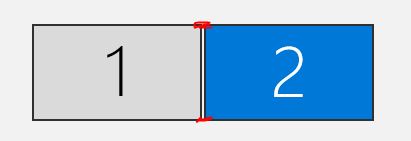

    1. My monitors are side-by-side. In this situation I find no way to connect them more closely than shown below. They seem to snap into position here. I can try to overlap them, to place them closer, wider... but they always connect like this. Not that I want but I can move one or other up or down to offset... and I appreciate that would need to have the effect which I am trying to remove
    Anyway, with monitors like this I get the problem moving the cursor in the regions roughly marked with Red ink.
    Windows 10 - Mouse cursor sticks to edge between multiple monitors - Continued ad411990-f79b-4c05-818a-0ec822cff7a9?upload=true.jpg
    2. If I reconfigure so they are under each other, as shown below, directly connected and aligned, the problem is *still* present. Move cursor upwards on the left side of 2 and it gets stuck top-left.
    Windows 10 - Mouse cursor sticks to edge between multiple monitors - Continued dc6cd60a-ae68-4bfa-a8a4-0357f7ba8113?upload=true.jpg

    I did get a suggestion that worked: Open the Display settings, use you mouse to drag either the leftmost or right most monitor icon (I have two monitors and a laptop, which is the center monitor) away from the center monitor icon, then release. That forces
    the icon to 'snap back' to the center monitor icon. The cursor stops sticking after you do that. If I disconnect the laptop to travel, etc., the problem sometimes reoccurs but is corrected by just repeating the steps. .
