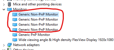

    So I have Lenovo ThinkPad t440p and was trying to install WSL2 so when i enabled virtual machine platform, after restarting PC i got 4 additional non-existent screens. I had also downgraded my intel hd 4600 drivers, but nothing happened , but disabling virtual machine platform solves the issue but i want to use WSL2 .community please help me sort this issue I had also ran this script iwr -useb https://christitus.com/win iex for tweaks may this caused an issue I don't know.I don't want to disconnect them I really want to solve this issue completely.

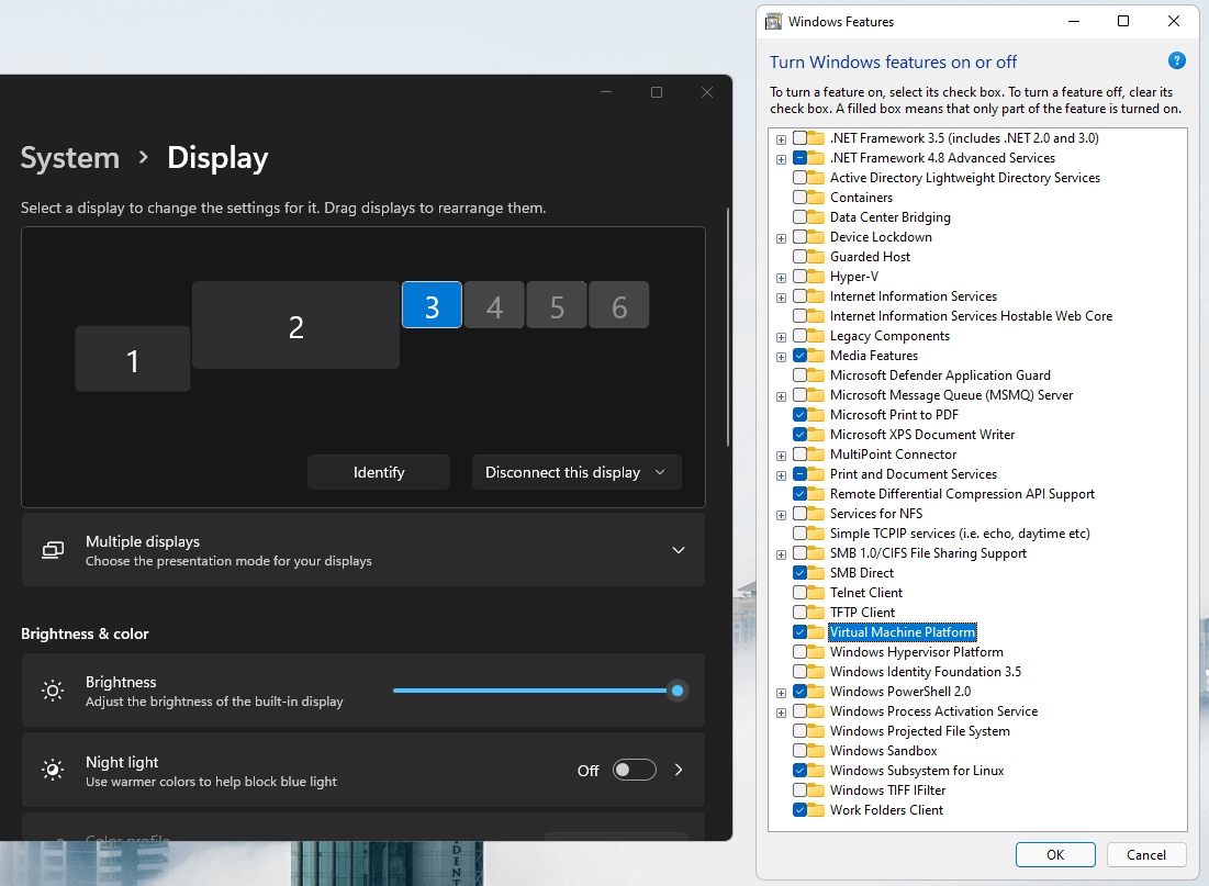

    I'm trying run WSL2 on my Win 11 22000.556 (ThinkPad t440p) and after thicking "Virtual Machine Platform" in "Turn Windows features on or off" I'm getting unwanted virtual displays I cannot access (3, 4, 5, 6).
    I disabled them to stop moving apps there but when I unplug my external (primary) monitor, the only laptop's display is not set to primary and I am not able to do anything.
    Good ppl, How can I get rid of them please?
    !!! SOLVED !!!
    Windows 10 multiple non-existent screens - Microsoft Community
    Windows 10 multiple non-existent screens when i enable Virtual machine platform 7812445b-788d-4372-bc78-bda0fa484d60?upload=true.png
    * if I disable "Virtual Linux Platform" and restart system, virtual displays disappears
    ** persists even if Hyper-V is enabled with/instead of Virtual Machine Platform
    *** virtual displays are shown in Device Manager
