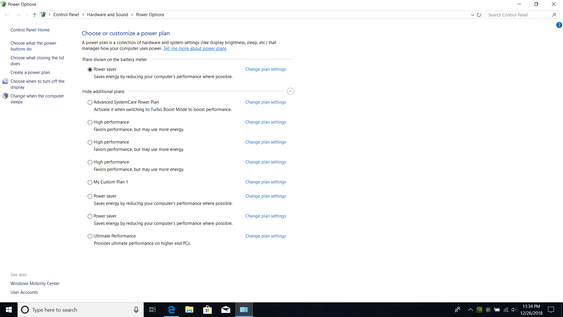

  1. Windows 10 Power Plans are missing.
    This is frustrating me out, my balanced,high power and power saver are missing...
    I looked at other posts "Didn't work"
    Then I look in control panel and it's glitched out.
    Windows 10 Power Plans are missing. 67950a0e-e037-4f05-8194-83eb6a4a30d1?upload=true.png
    PotatoChips101, Dec 26, 2018

  4. antares Win User
    Restore Missing Default Power Plans in Windows 10
    Hi Brink, there's good and bad news *really
    The good news: I was able to restore all missing power plans. The bad news: the restored power plans show up as long as Modern Standby is disabled (value 0 in csenabled registry key).
    Here is what I did:
    I started having "Balanced" as the only power plan displayed. I then disabled Modern Standby as you suggested and multiple instances of the various power plans showed up as seen below:
    Windows 10 Power Plans are missing. [​IMG]
    So I then went ahead to delete the added power plans to start from a clean state using your instructions
    I then added the power plans using Powershell as explained in this thread. The power plans were added successfully as shown below:
    I then enabled Modern Standby, rebooted and this was the result:
    So I disabled Modern Standby and finally got back the missing power plans again:
    Also I observed another change: now, the power icon in system tray does not show the slider to set it to save or best performance, as seen below:
    So the question remains: how to have Power in Control Panel show all Power Plans without having Modern Standby Disabled.
    antares, Dec 26, 2018
