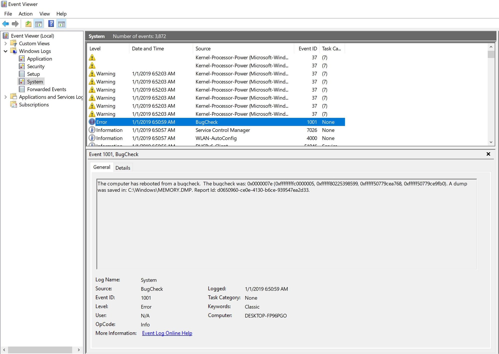

    Earlier this morning, I wake the computer from sleep/hibernate (I have computer set to hibernate after 180 minutes, this is actually probably the default setting). Unfortunately it opens with a restart, so I log in, and take a look at the windows event viewer system log, and here are my findings:
    Windows 10 Pro BootCamp Restarting after sleep/hibernate 8f6dc04e-bc62-4849-a4a5-9cd6aa8ab895?upload=true.jpg

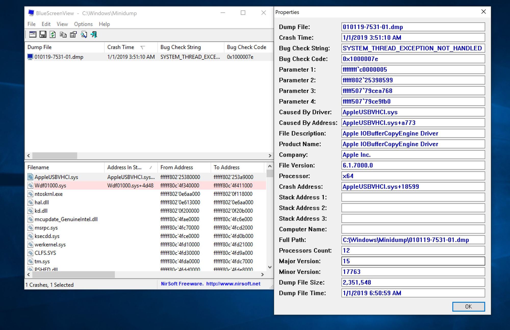

    So I confirm that essentially, it did restart during the sleep/hibernate phase. I then proceed to download BlueScreenView to take a closer look at the BugCheck error, and here were my findings:
    Windows 10 Pro BootCamp Restarting after sleep/hibernate a5e0d761-2947-488c-8b11-609882a45a0b?upload=true.jpg
    My guess is that this is a driver issue, so my instincts were to go to the device manager module, and to scan for any hardware changes, which yielded nothing. I go to that specific driver, which was hiding under "System Devices", and I check for any updates for the driver, to which there aren't any...
    Note: I have the high end MBP 2018 w/touch bar model, with Mojave OS installed, and firevault encryption is turned off.
    I'm now at a loss as to what to do...any help or advice would be appreciated. You have my gratitude in advance!
