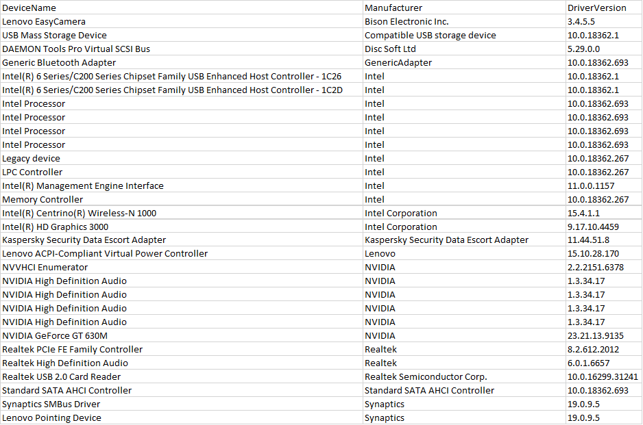

    As of year or so I've started getting these annoying BSODs and in most of the times 99% they have the quoted error code behind and for the rest - "KERNEL MODE HEAP CORRUPTION". As I've got annoyed quite too much, I've decided to make a clean fresh install of Windows 10 Pro licensed of course, however, after a day or so I've again got the BSOD with the "IRQL_NOT_LESS_OR_EQUAL" error code and I've started reading around for some troubleshooting steps and here's what I've performed so far:
    1. First of all I've read the MEMORY.DMP and mini-dump which pointed out to errors in regards to "ntoskrnl.exe" and "ntkrnlmp.exe".
    2. Then I've found out that the error about "ntoskrnl.exe" could have something to do with the RAM. My laptop has 16 GB 2x8GB of RAM so I've decided to do a test on both blocks with MemTest86 Pro v.8.3. I've removed one block of RAM and performed 4 passes taking about 5 hours and 20 minutes ending up with not a single error. Then I've swapped with the other block of RAM and have performed again 4 passes for approximately the same time - again not a single error. Then I've performed last test with both blocks or RAM again 4 passes taking about 10 hours and 10 minutes - again not a single error.
    3. Since not a single error showed up on the MemTest86 Pro, I've continued down the road of the troubleshooting and pointed my attention to the "ntkrnlmp.exe" - testing the drivers with the "Verifier". In order to do so, I've followed this guide - Driver Verifier-- tracking down a mis-behaving driver by ZigZag3143 MS -MVP, however, after making the suggested settings and reached to the point where I had to restart my laptop, I've ended up in an infinite restart loop or at least until the 2nd auto-restart at which the Windows Auto-recovery kicks in. Fortunately, I was able to boot up in Safe Mode in order to stop the "Verifier" and then boot up normally to Windows.
    Unfortunately, this is as far as I can go with the troubleshooting so I'd need some further help in order to identify the exact cause of the BSOD.
    I've uploaded the MEMORY.DMP and mini-dump along with the output of the 3 tests from point 2 here - https://1drv.ms/u/s!AqarvueaailfkR62OmZmUARoEp58?e=nxkhjg. Also it is worth mentioning that the image I've used for installing the windows is one of the latest one which I've downloaded through the Media Creation Tool and after that updated to the latest updates. As for the drivers, the laptop has Intel HD3000 and GeForce GT630M, so the Intel one is installed automatically by Windows and the nVidia has been installed manually with the latest version available through GeForce Experience application. Here's a list of all drivers which are non-Microsoft:

  2. mad1394 Win User
    IRQL_Not_Less_Or_Equal
    sigh
    If your computer auto restarts on BSOD find the setting in windows to make it stop.
    Second step is to look for the error code of the BSOD.
    Perhaps easier would be to use an online application such as bluescreen viewer.
    Once you know which driver is causing the problem you can look further into fixing it.
    mad1394, Apr 23, 2020
