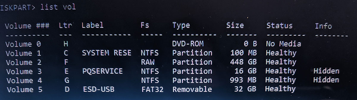

    I am reformatting and reinstalling Win10 on a laptop which was previously upgraded from Win7 to Win 10.
    The reformat went ok, and Windows 10 install began, got as far as establishing connectivity to my Wifi but when it restarted it keeps coming up with a stop code: NTFS File System error.
    I've created a Win10 Installation media USB drive and got command prompt on the troubleshooting menu system repair didn't work
    Tried a few things from here but none are working correctly
    Check Disk - Everything is ok
    Have tried to run:
    • bootrec.exe /fixmbr
    • bootrec.exe /fixboot
    • bootrec.exe /rebuildbcd
    • bootrec /scano
    /fixboot - got access denied
    /rebuildbcd - It says 0 identified Windows applications
    tried sfc /scannow
    - Verification 100% complete
    - Windows Reource Protections could not perform the requested operation
    Went into DiskPart it shows me as image below for Disk 0 - I'm thinking something is wrong here???
    Windows 10 Reinstall failing with Stop code error - NTFS File System 47c677fe-5237-4f0a-ad86-2ee8cc6110f6?upload=true.jpg
    Any help on how to sort please? Am trying sort the laptop to give to a friend for their boy to do his home schooling on during the current covid lockdown.
