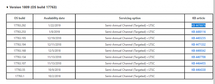

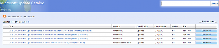

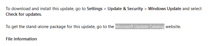

    If you have tried, all of the above suggestions and nothing has worked like in my situation. This is how to fix the problem.
    SOLUTION
    As you can't update via the settings app, follow these instructions.
    1. Hold Windows key & press R
    Type in winver (this will show you your windows version)
    Mine was (Version 1809 OS Build 17763.253)
    2. Check if there is a higher update available e.g (Version 1809 OS Build 17763.292)
    You can do this here HTML Code: 3. Click on the KB article that is relevant to you.
    Windows 10 settings app closes almost instantly after opening it 223976d1549843064t-settings-metro-app-instantly-closes-cant-diagnose-issue-kb-article.png
    4. Scroll to the bottom and download the standalone update by clicking on Microsoft Update Catalog.
    Windows 10 settings app closes almost instantly after opening it 223977d1549843208t-settings-metro-app-instantly-closes-cant-diagnose-issue-stand.png
    5. Download the correct system architecture.
    Windows 10 settings app closes almost instantly after opening it 223978d1549844086t-settings-metro-app-instantly-closes-cant-diagnose-issue-updates.png
    Install and this should resolve your problems - if it does (CREATE A NEW SYSTEM RESTORE POINT)
    Hope it helps *Wink
    Pleasehelp2019, Feb 24, 2024
