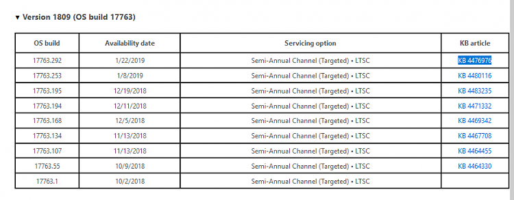

    2. Check if there is a higher update available e.g (Version 1809 OS Build 17763.292)
    You can do this here HTML Code: 3. Click on the KB article that is relevant to you.
    Windows 10 settings app closes almost instantly after opening it 223976d1549843064t-settings-metro-app-instantly-closes-cant-diagnose-issue-kb-article.png

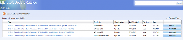

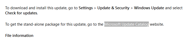

    4. Scroll to the bottom and download the standalone update by clicking on Microsoft Update Catalog.
    Windows 10 settings app closes almost instantly after opening it 223977d1549843208t-settings-metro-app-instantly-closes-cant-diagnose-issue-stand.png
    5. Download the correct system architecture.
    Windows 10 settings app closes almost instantly after opening it 223978d1549844086t-settings-metro-app-instantly-closes-cant-diagnose-issue-updates.png
