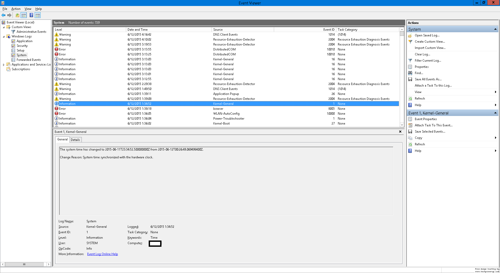

    Every so often my time on PC was resetted to 2 hours in the past. I checked my settings for synchronizing time with an Internet time server but as I knew, synchronization was turned off. So I started looking at other reasons and I found this entry in Event Viewer:
    Windows 10, System Time Dizzles Away, System time synchronized with the hardware clock Seen... 11.png
    It says:
    I do not know why did Windows synchronizes time with my time in BIOS but it is wrong and I never requested it nor did I turn it on.
