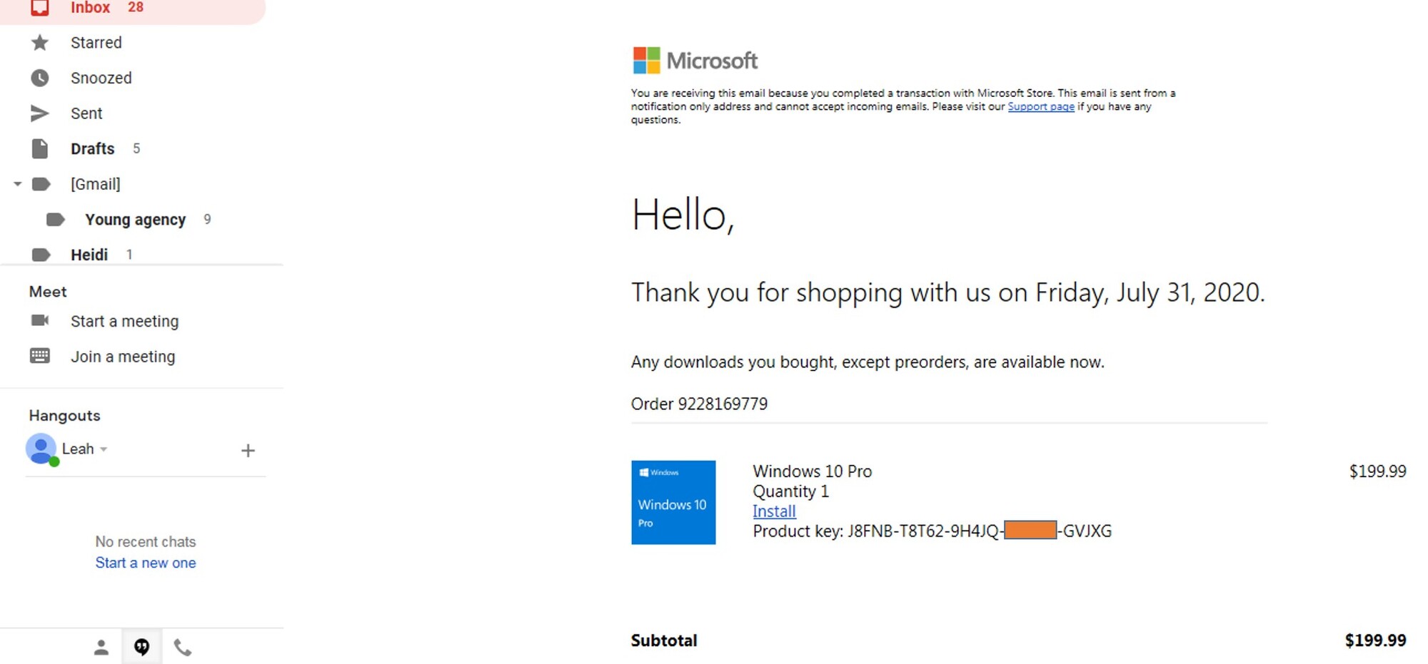

  1. AlexiaKim Win User
    Windows 10 Update keeps failing - "0x8007001F - 0x20006
    Please help me how can I upgrade window 7 pro to 10 pro.
    Thank you
    Windows 10 Update keeps failing - "0x8007001F - 0x20006 cbb7e034-bab9-47f2-a010-62774258cebb?upload=true.jpg
    AlexiaKim, Jul 31, 2020
