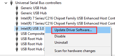

    Hello my name is Bradford and I'm an Independent Advisor for the Microsoft Community and I'll help you with getting your hub to work at USB 3.0 speeds.
    Please be sure to download proper USB 3.0 drivers from the official site of your PC manufacturer. You can also find USB 3.0 drivers updates on the motherboard manufacturers’ websites if you built the computer yourself.
    Save the driver file and follow the steps below to manually install the USB 3.0 driver:
    1. Use Windows shortcut keys "Windows Key + X" to launch the Jump List and then select "Device Manager".
    2. Right-click on the USB 3.0 device, for instance, "Intel USB 3.0 eXtensible Host Controller". And then select "Update Driver" Software.
    3. Choose "Browse my computer for driver software".
    4. Click the Browse button and load the USB 3.0 driver you’ve saved. Click OK and then click Next. Then Windows 10 will do its jobs on and install the driver.
    5. Restart the computer.
    After following these steps your device isn't working faster please let me know and I can suggest a different solution
    Windows 10 USB Root Hub 3.0 Stuck in Reboot Loop, Cannot Uninstall? 69864322-f73a-46b8-a783-bd6e0840b188?upload=true.png
