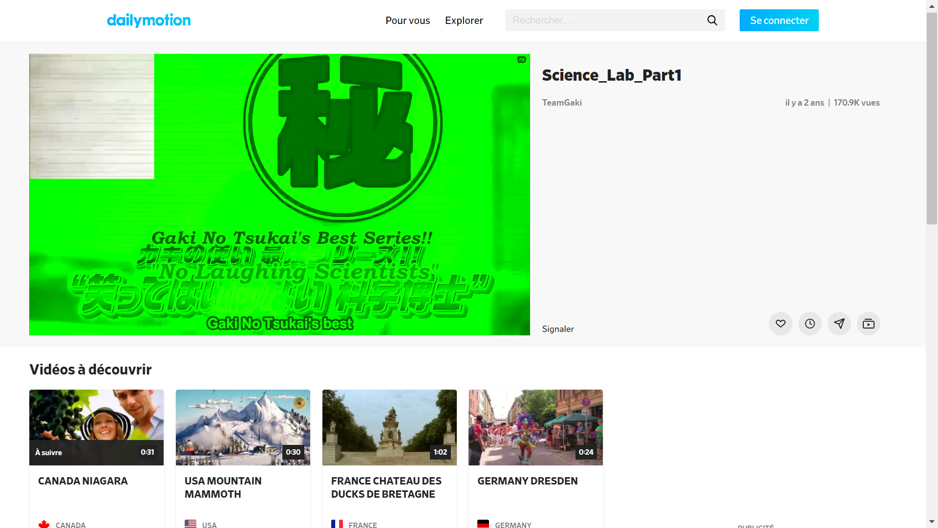

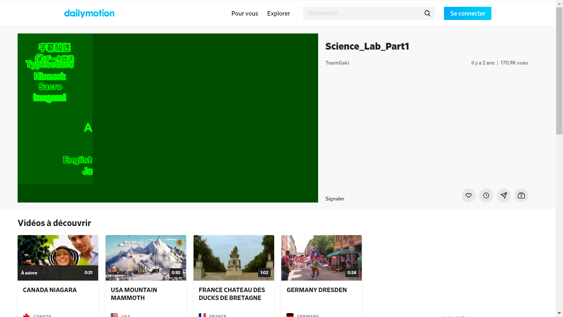

  1. Windows 10 Video Streaming Glitch
    Whenever I stream a video online, random green glitches appear over the video. It especially happens when I hover my mouse over a video or go in and out of full screen. This is what it looks like. Windows 10 Video Streaming Glitch 77b0b136-99e8-413e-91fc-437660828285?upload=true.png Windows 10 Video Streaming Glitch ac577519-0507-4dac-937f-3b409e428651?upload=true.png
