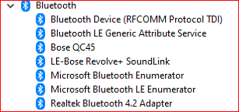

    Just an FYI - I recently bought Bose QC45 headphones. After being unsuccessful yesterday, today I was able to successfully pair/connect to my Windows 10 desktop Bluetooth. The advice above about first removing previous attempts and deleting relevant entries from Device Manager seemed to be the keys.
    After turning on the headphones, I went to Settings| Bluetooth & other devices| Add Bluetooth or another device. Also had pressed the headphone on/off button to the far right. Eventually it connected.
    Windows 10 won't recognize & Pair Bose QC45 Headphones 362178d1647300647t-cant-connect-bose-qc-35-ii-headphones-inwindows-10-a-image.png
    This is what Device Manager shows at present:
    Windows 10 won't recognize & Pair Bose QC45 Headphones 362177d1647300382t-cant-connect-bose-qc-35-ii-headphones-inwindows-10-a-image.png
    Hope that is helpful.
