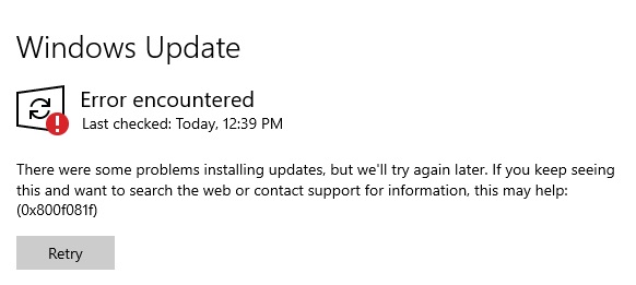

    According to our comments section, community forum, Feedback Hub, and other complaints on Reddit, Windows 10 KB4571756 is failing to install with the following errors:
    “There were some problems installing updates, but we’ll try again later. If you keep seeing this and want to search the web or contact support for information, this may help: (0x800f081f).”
    Windows 10’s important updates may fail to install, but there’s a fix Windows-10-update-error-0x800f081f.jpg
    And…
    “There were problems installing some updates, but we’ll try again later. 2020-09 Cumulative Update for Windows 10 Version 2004 for x64-based Systems (KB4571756) – Error 0x800f0922.”
    Windows 10 KB4571756 or future updates could also fail to install with the following error messages:
    • 0x800f081f
    • 0x800f0922
    • 0x8007025d
    • 0x800f0988
    • 0x8007000d
    • We could not complete the install because an update service was shutting down.
    How to fix Windows Update errors
    The good news is that if you get an update error highlighted above, you might still be able to install the cumulative update manually using the Microsoft Update Catalog or Media Creation Tool.
    When you run the media installation tool and use ‘Upgrade this PC now’ option, it will assume that you want to reinstall the latest cumulative update, which is exactly what you need to do.
    This is not a clean install and your files won’t be removed. Instead, Media Creation Tool will allow you to apply updates missing on your device. Currently, Microsoft is offering Build 19041.500 via the Media Creation Tool, but the tool will be refreshed with Build 19041.508 (September update) by the end of this month.
    That’s because the tool is now updated in the third or fourth week of every month with the latest Patch Tuesday release.

  2. jds21 Win User
    I just did step one and they have just all installed.... thank you so much.... it was quite frustrating having that update window pop up every 5 minutes and failing to instal every time
    Thanks mate
